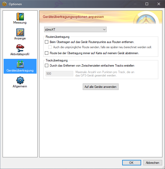

@jfheath and @Deepdiver51
And also, and this is very(!) important, do not forget to get the right settings in Basecamp under 'Options/Device Transfer' - the settings there are essential for what the Zumo XT is doing after a route is imported in it!
Especially the option 'Always adjust route to the maps on my device' is really misleading! What it does, is mostly not what we want - this option will tell the Zumo XT to ever(!) recalculate the imported route, nevertheless what are the settings on the Zumo XT are otherwise and even if the same maps on Basecamp and the Zumo XT are used! I think, its very important to know what this setting in Basecamp does...
Best setting in 'Device Transfer' is, that no one of the three points are selected!
Sorry, if some advises above not have the right names in english, but i think you'll know it when looking at the picture
Bye, Robert :)

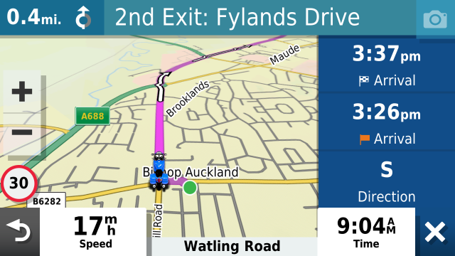

Just two more quick questions: 1) Is there a way to get a small compass or North arrow on the screen? This would or may have prevented me from going back on myself. 2) Is there any way to see the current time? It shows the Time of Arrival but trying to look at your watch at night, in the dark in the rain and under two layers of rain gear is a major PITA.

No - not a compass, but you can put a direction of travel indicator on - which shows the 8 points of the compass.
Is this something that would be of use ?
All 4 of those 'buttons' on the right are configurable.
To display that right hand panel - close down anything that is there already: Tap the cross, bottom right.
Then tap the three dot button that appears where the cross was - bottom right.
That opens up a menu with a choice of all sorts of things. Choose Trip Data.
Then you can click on each of the 4 buttons in turns and choose what you want to be displayed in that position.
The XT remembers the 4 buttons that you have created but it remembers a different group of 4 depending on whether or not you have a route running. The Zumos used to remember different sets for car and motocycle too, but I don't think that the XT does now. I've not tried it recently.
So if you pick up your XT and create the 4 that you want and then expect it to display those when you are following a route, you will be disappointed.
You have to load a route and select Go !. Then set your Trip Data display with the 4 data items that you want.
If you do not want the 4 data items, and you are happy with just one, then the bottom right white button can be configured by itself - but since you said you wanted time of day AND direction ...... The trip data panel doesn't really affect the navigation screen. It trims the left and the right side a little bit, but it also shrinks the map a little bit. I have something displayed there all of the time. It has never been an issue for me.
The speed button, bottom left cannot be configured.

The “Direction” will certainly help.
In your image it shows the time of arrival at the destination and then also shows a time at the bottom. Is that then the current time? Mine was always showing the time of arrival.
(Boy, have I got a lot to learn!)
Re: XT Routing problems
Deepdiver51 wrote: Mon Aug 26, 2024 11:04 am In your image it shows the time of arrival at the destination and then also shows a time at the bottom. Is that then the current time? Mine was always showing the time of arrival.
Yes - I have put the time at the bottom. The time at the top is the time it expects me to reach the end (chequered flag), 3:26 orange flag is the time that I will arrive at the next Via point. Via points are usually considered as stopping places (must visit places).
