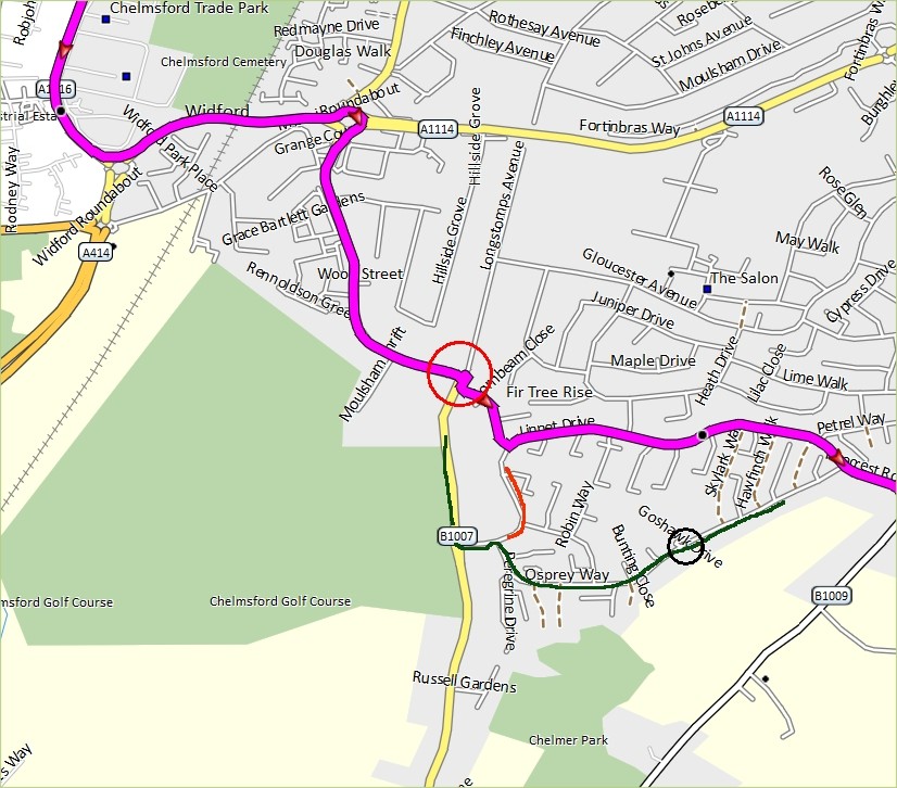

Interesting. A few observations - which might contribute to the moved shaping point. Or not.
The track that you included does not follow the roads exactly on my 2025.2 map. So I had to recalculate the routes.
There were a few differences from your track in Basecamp and my route as a result.
We know that all route points move slightly. Garmin seem to be catering more for the inaccuracy of people trying to produce accurate route maps on tiny screens with small fingers. So it seems that most points in a route are subject to slight modification. When placing a route point on the tread app on the iPad and Android phone - you place a point - it pops up a list of things that are nearby and you get to choose one of them. This places the point accurately on a road. It also tells you whether or not the location is supports for motorcycle routes. Routs containing route points seem to undergo a similar validation check ! But it seems to move them to places that are on the route that you planned.
However - what you point out reveals some really interesting behaviour when it cannot actually follow the route that is plotted. I'm talking about near the roundabout on the B1007 at a junction with Longstomps avenue - SW of Great Baddow - near the easter end of your route home.
I have drawn a red and a green line. Just above, circled, it goes down Dove Lane. There in no road that links the B1007 and Dove Lane. There is a cycle and pedestrian path. But no way that the satnav can calculate a route for the motorcycle. So it either has to give up, or esle come up with an alternative.
Your route lines and my maps did not coincide - so I recalculated the route before sending it to the XT2. BC produced a route that followed the red line - doubling back and going through the fixed route point on Linnet Drive.
The XT2 did something different. It decided it couldn't get to that shaping point and moved the shaping point to where the black circle is - and plotted the green route.
Whether or not this was due to the map that your plot follows not being quite on the mapped roads - I don't know. But we do know that under certain circumstances, when the XT1 recalculates a route, its behaviour changes. It seems to be a different kind of route - where the route takes priority over shaping points for example. It will let you completely ignore Via Points - and they disappear as you drive past. But then it changed on my route too - and that didn't try to take the cycle path.
So you are right. It moved the route and the shaping point. But it raises some questions for me to ponder.
So just thinking out loud here. I'm not asking these questions of you !!
Did it know about the original route. If so did it try to keep close to it ?
If it only had the shaping points to go on, why did it move one of them ? Would it have done it if there were two shaping points.
Would it have done it if there wasn't a route error.
If it did know about the original route and that it was impossible - did it then recalculate it using a different set of rules.
I recalculated the route before sending it to Tread - so as far as the route was concerned - the Tread app didn't receive any incorrect routing.
I don't mind it changing a route between shaping points. Your routes did that in a few places. That's down to the person doing the route planning to place points more appropriately. (Not you or me in particular - just in general.)
Thanks for that input - food for thought, and very useful.

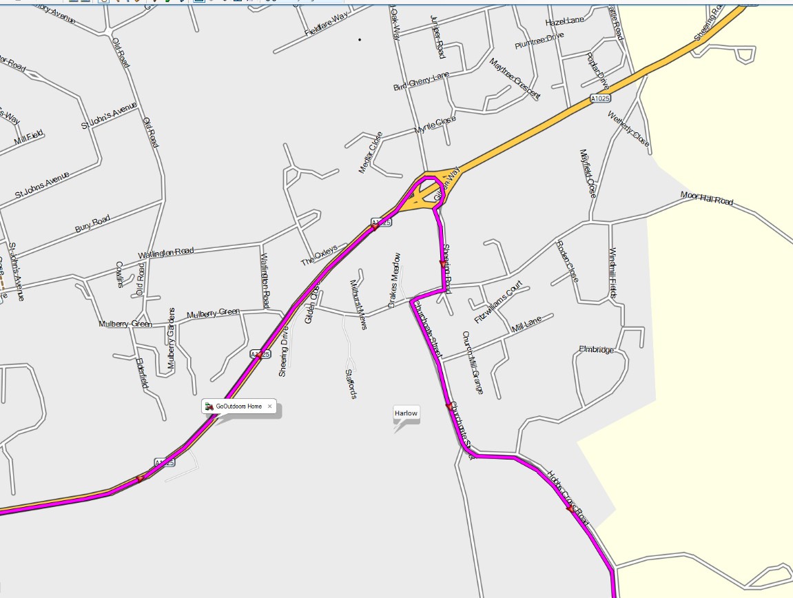

For some reason my maps were not available and the route was quickly planned with UKI and yes, more route points certainly would have helped.
On the XT2 the route there was OK until the 5th route point (The Plain) where it wanted me to double back and take the Woodside shortcut road to Thornwood instead of carrying on to the junction and turning right onto the B1393.
On the return journey at the 5th roundabout where the route should have turned right, that is a hamburger style roundabout which is clearly signposted way back down the road, No Right Turn! Trying to report a map error just produces a white blank box.
I'll try another route to test.
