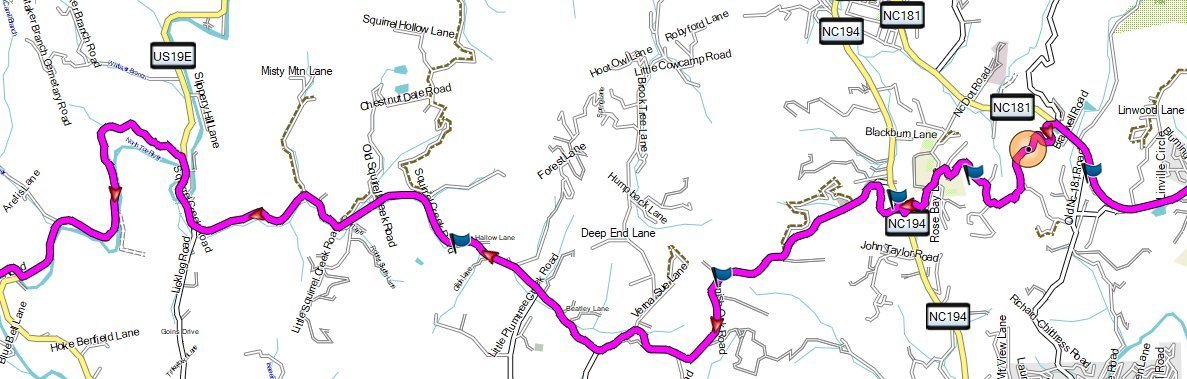

I downloaded the route - being in the UK, I don't have access to the Garmin USA maps, so I downloaded and installed OSM maps for North Carolina for Basecamp and the Zumo 595.
Here is an extract of the short route. A start, end, 6 Via Points, One Shaping Point. Click the thumbnail to get the larger image
And here is the route list - I have omitted the start and end points from both of these images.

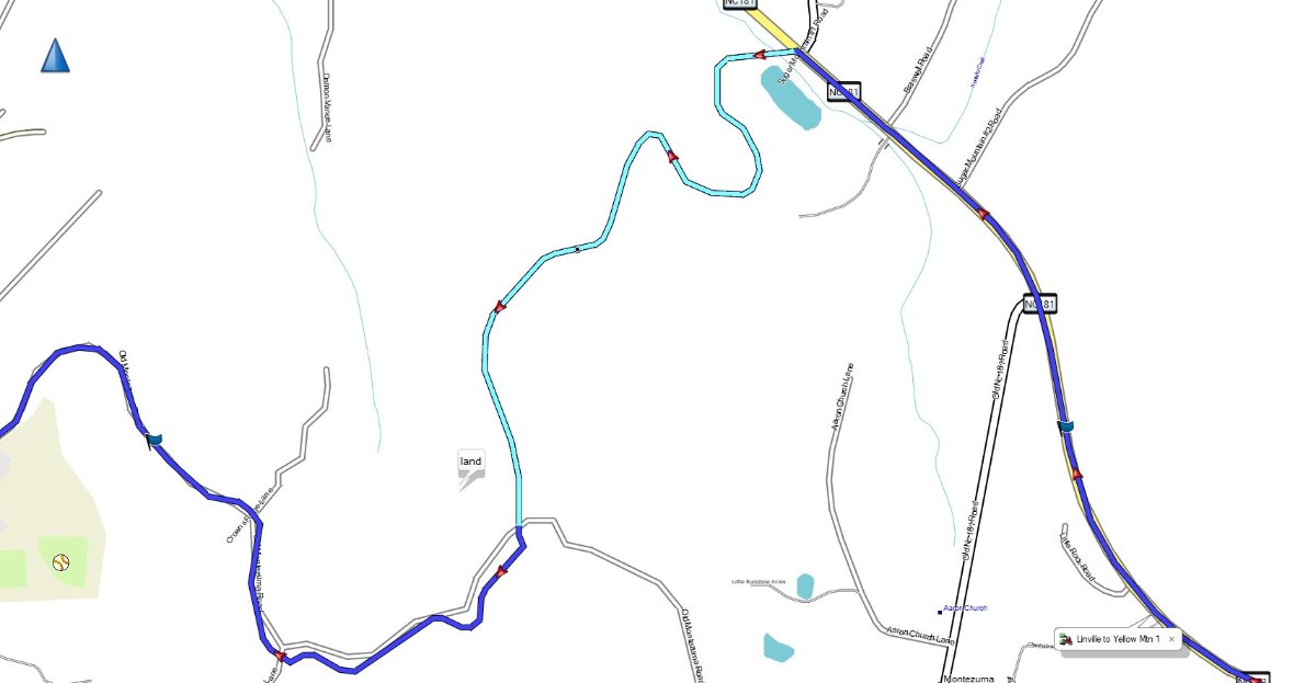

Now, on my OSM maps, the shaping point at Thistledown Lane is in a location where there is no road. I haven't been able to confirm, but the route I downloaded clearly went through this point and follows what now appears to be a track from the Google Satellite images. From the street view photos, there has been no road junction on the NC181 for any of their photos - which date back to 2009.
The stretch of road that doesn't exist according to my OSM maps is shown on this detail - I have coloured it in a light blue.
If all of that is actually the case and that USA maps show this as a navigable road, no wonder Russ is having problems.
