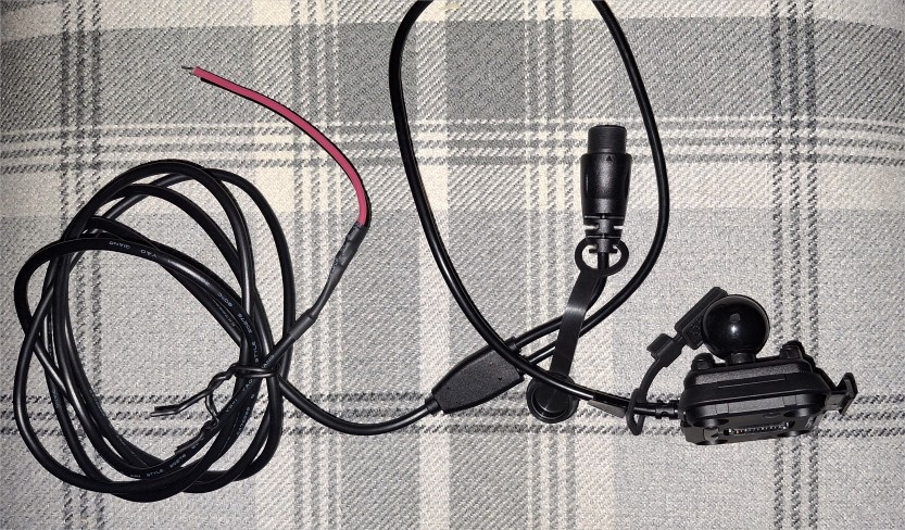

So - I ordered TWO of the new Y cables. Y-Adapter Kit 010-13985-00 The website now has a price for them and at the time I ordered them, a delivery of about 1 week. THis was better than the previous time of 3-5 weeks. They both arrived today.
I bought two because half of the price was recovered by sending the previous two back. And it will be worth it to have an XT2 cradle on my desk so that I can plug in the handlebar controller to find out how it works without having to brave the freezing cold in the garage. Providing I can wire the controller so that I can take it off fairly easily.
Handlebar Controller.png (51.75 KiB) Viewed 6472 times
Y Adaptor.jpg (205.63 KiB) Viewed 6472 times
The cable comes with a new XT2 cradle.
The cable length from the cradle to the bare ends is 240cm / 2400mm.
The Y spur of the main cable is 50cm / 500mm from where the cable feeds into the cradle.
The wire joinint the screw in USB C connector to the 'Y' moulding is 6cm / 60mm
The cradle comes ready wired with the RAM ball mount in place.
The harness has 10cm / 100mm of black/red joined wire with bared and tinned ends. No connectors.
