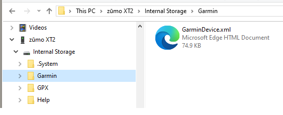

Connect the XT2 to personal computer via USB cable. On the zumo tap to connect to computer. It takes a minute or so for the zumo to show up on the pc but it will. Navigate to and open GarminDevice.xml

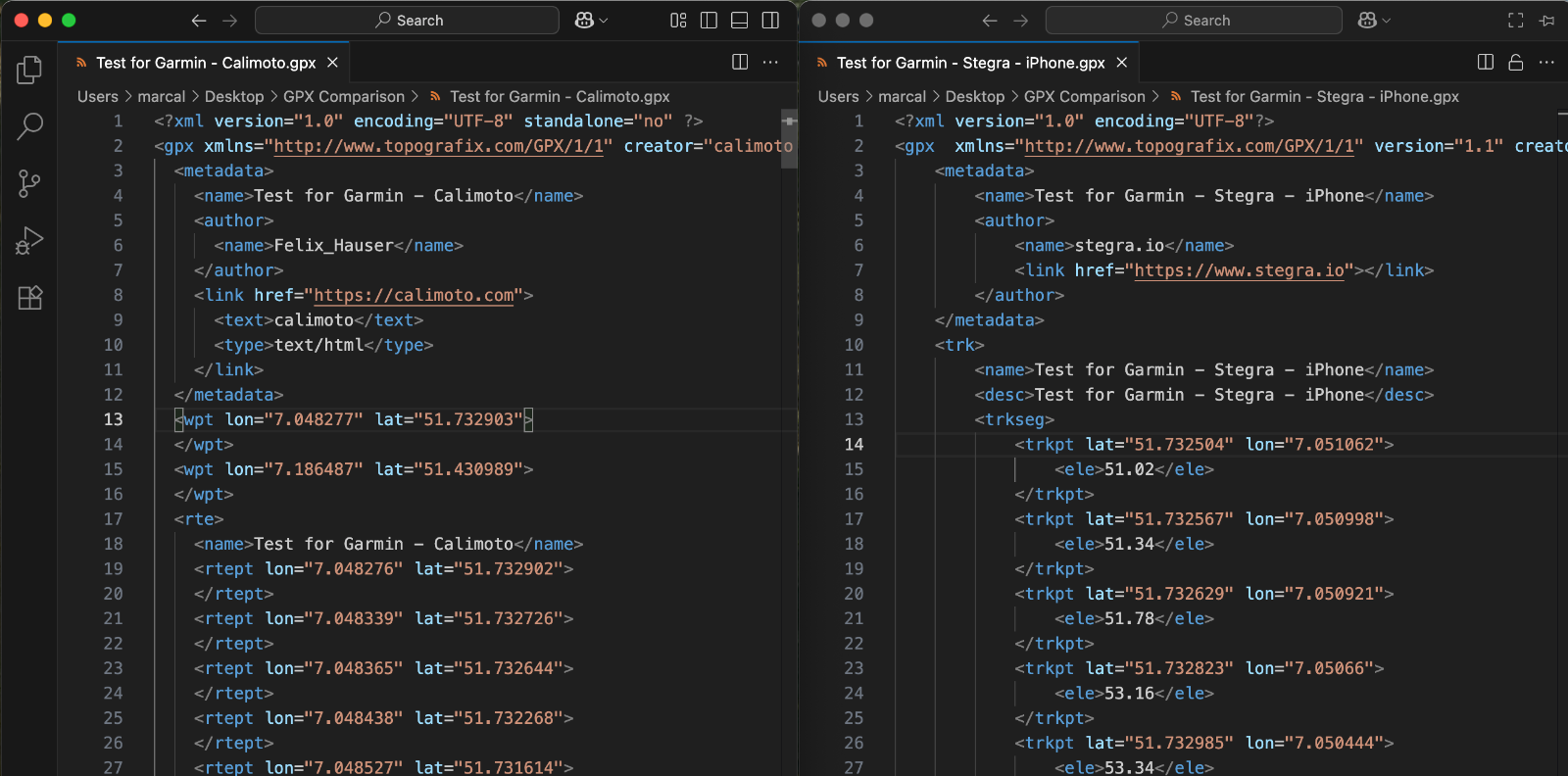

Well, it appears both files are more different than I expected.
On the left side, there is the Calimoto file. On the right side Stegra. As you can see in both cases it's just a collection of gps data, but with some differences:
- Stegra includes elevation data. Calimoto does not. That alone makes the file quite larger is size.
- the gps data are wrapped with <trkpt></trkpt> in Stegra and <rtept></rtept> in Calimoto.
I consulted my AI assistant regarding this matter. Apparently Calimoto's format is more typical for a route planner. On the other side what Stegra creates is more typical of a Track Recorder, such as what Zumo XT2 itself makes. The Stegra format is much more dense point-wise. That means, it creates a point every 2 meters (for instance) instead of every 10 or 20 meters on calimoto.
The combination of all together can lead to unexpected behavior on some SatNavs.
Solutions include preparing shorter tracks or converting and pruning the elevation data.
Again, in my opinion, it boils down to a memory management problem on the side of the device. Also in my opinion, it doesn't matter how much bigger the Stegra files are, this should not happen on modern devices. Period.
I also noticed that the last track which gave me problems had all the elevations set to 0. No idea why.
I will try to reach out to Stegra. I wanted to do that anyway to address some issues I've noticed with the App.

As you probably know, tracks (what you have from Stegra) and routes (what you have from Calimoto) are very different things in terms of how they will be handled by most any SatNav device.
I would guess that the zumos ignore elevation, but I really don't know.
