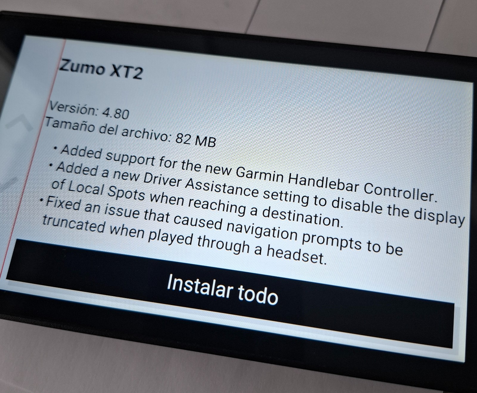

New software version for XT2 (4.80):
- The problem of Bluetooth interruptions with Tread App enabled during synchronization or calls is not solved.

"Local Spots" is in the Driver Assistance tab and was set to "on" when I powered up my XT2 after the update.
