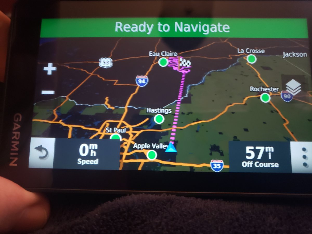

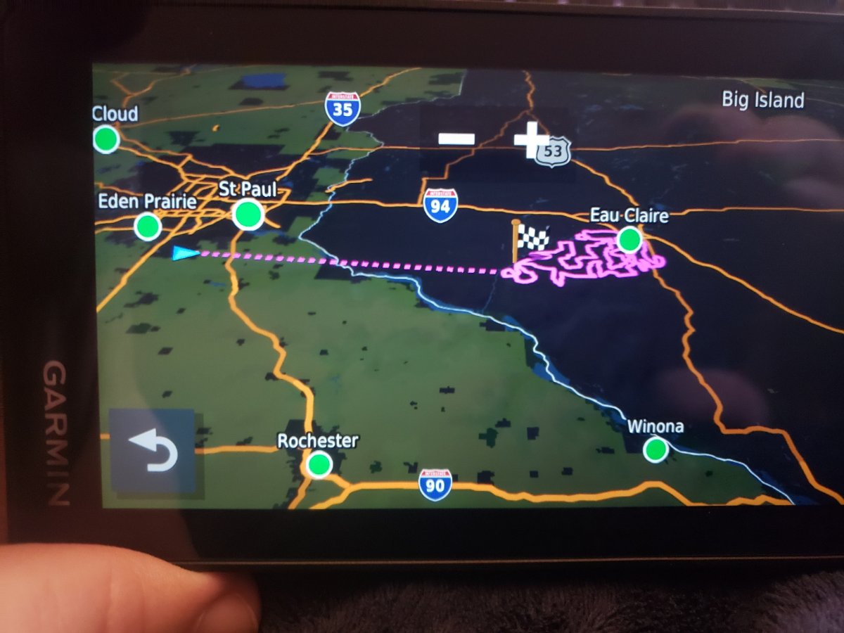

Re: New Firmware
say, i see how to display all tracks, groups of tracks, but how do i choose to display 1 track. ??
it use to be an option to display, along with setting color and other things, (yes i see the set color)
I usually show a track, then navigate over the track, so both are displayed.
just updated maps, and software this morning. (using garmin express for all, and not in the gps using wifi) thanks for your time.
trying to start a track, say start to finish, then it gives me a straight line, ummmmmm
sigh, this doesn't seem good....sits at calculating at 99% for a long time. then ready to navigate, then straight line, drive to end.

JS_racer
- Posts: 75
- Joined: Sat Jun 13, 2020 12:18 am
- Location: Minnesota
- Has liked: 11 times
- Been liked: 4 times
Re: New Firmware
should I do a full reset ?? I have backups of the tracks and routes that were on it, I think. didn't have a ton, because I was testing it out compared to my rider 40/400. no coms, or anything connected, just the phone application, and garmin express
