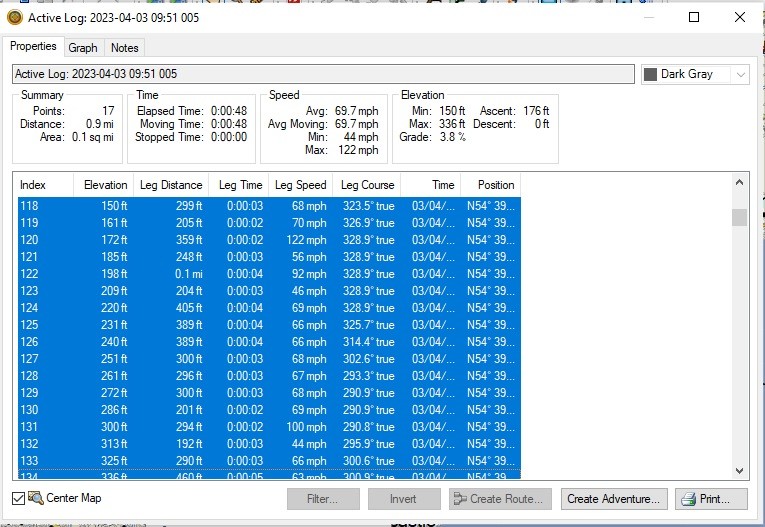

The answer is that it isn't possible. It displays the speed that you think you are going - ie the speed that you were going before entering the tunnel, so it estimates where youa re based on that speed. Speed limit was 40 at the time I think. I entered at 30. And then when out of signal range, I sped up to 40, and continues to the end. The stanav thought that I was much further back inside the tunnel, when I hit daylight (and satellite reception) again. The satnav works out speed by calculating distance / time. So in that couple of seconds when it got my new accurate position from the satellites it was calculating my speed from where it though I was - much further back, to where I actually am. So in that couple of seconds, I had travelled quite a distance. I exited the tunnel at 127mph. Apparently.
This is a slightly different behaviour. This track log was recorded with the bikes cruise set to 70mph (GPS) 74mph (bike) on a stretch of dual carrageway with clear view of the sky and no overpasses. Most peculiar. The average speed of 69.7mph for this section is correct as i had the cruise set. But I didn't have excursions to 122mph and 100mph respectively......its an Africa Twin :)

Mzokk wrote: Wed Apr 05, 2023 12:16 pm This is a slightly different behaviour. This track log was recorded with the bikes cruise set to 70mph (GPS) 74mph (bike) on a stretch of dual carrageway with clear view of the sky and no overpasses. Most peculiar. The average speed of 69.7mph for this section is correct as i had the cruise set. But I didn't have excursions to 122mph and 100mph respectively......its an Africa Twin :)
It has got to be to do with the satellite reception. It works out the distance from the lat/long coordinates, and calculates the speed from the change in distance and the time. If you look at the fast speeds in your log, in 2 seconds you traveled 205 ft and in the next 2 seconds it was 359. Satnavs do have a tolerance and can usually be between 2 and 5 metres out of position. Sometimes it is much more. You can display the accuracy on one of the 4 trip data displays on the right hand side of the screen (landscape view - or across the bottom, portrati view). Press one of them (the white one, bottom right, is always available), and choose the data item that you want to display. GPS accuracy is down at the bottom of the list on mine and is currently displaying an accuracy of 10 yards. But I'm in my study.
But take my current error of 10 yards. That is 30 ft. That is a possible 60ft discrepancy between two consecutive readings - if one reading was out by 30ft in one direction, the next was out by 30ft in the other.
They can be pretty good at calculating the error, but its more difficult to pinpoint your precise location !
It can vary as trucks go past. There must be other circumstances too. I thought that it calculated a 'moving average' to get the speed - eg It seems to record a fix every second or so. But it will take the fix from 5 seconds ago up to the latest fix. and working out the speed from that. I don't know this. I have assumed it to be the case because when you accelerate hard or brake hard , it takes about 5 seconds for the satnav speed to catch up with your actual speed.

I think you might be onto something. I looked up the old Logs on my Nav4 when it was on my 2014 BMWr1200RT and there is no odd behaviour with jumping speeds. Same thing with my Zumo 340 and 390 when attached to my old R1150GS However, the Nav4 logs When it was used on my 2020 Honda Africa Twin Adventure Sports exibit the jumping speed thing in a similar way to the XT. The Irony is that the Honda TFT on the Africa Twin is made by......GARMIN!. The screen has a GPS antenna built into, which it uses for time and probably to ensure good GPS signal when you have a phone attached for Android Auto/Apple Carplay. Would be a bit of a kicker if two Garmin devices interferred with each other. :roll:
Likely the reason for the multiple track logs too!.
