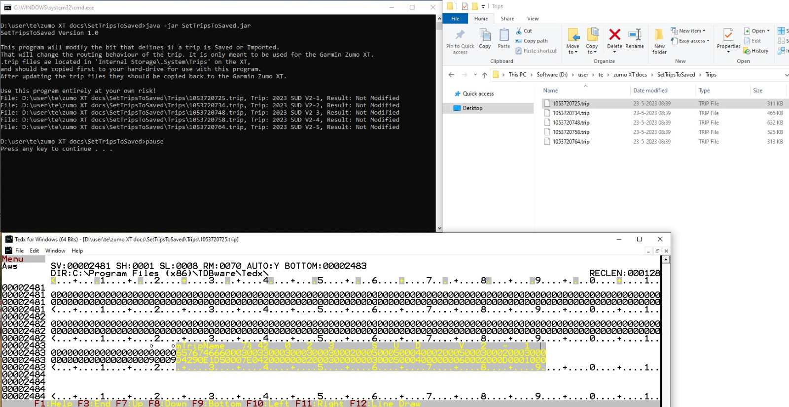

Peobody wrote: Tue May 23, 2023 8:51 pm since there is no way to identify the trip associated with a .trip file from the .trip file itself?
The tripname can be found in the .trip file. My experience is that it can be found at the bottom of the file.
In the bottom half of the screenshot you can see the 'mTripname' keyword followed by the name. Each character takes 4 bytes. I guess it's UTF32
In the upper right part you see how Windows Explorer displays it, and in the upper left part you see the output of the Java program, that displays 1) the file name, 2) the trip name and 3) If it's modified.
(And this is not an effort to persuade you to use the Java program!)

@FrankB, I should have anticipated that you would include the trip name as a connection between the .trip file and its trip. Nice touch!
(And now I might have to install Java just to check it out.)

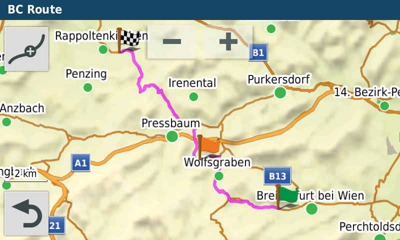

Here we go - as expected, 'BC Route' is listed under 'Imported Routes' and 'XT Route' is listed under 'Saved Routes'. Named the routes just as suggested from you, two nearly identical, short routes with one via-point in the middle, 'XT Route' was created directly on the Zumo 595 with the route planning tool and 'BC Route' was made with Basecamp and transferred via drag-n-drop to 'Internal Memory' - after a restart of the Zumo 595, it asks if i want import a new found route to the route planning app, and i said yes...
Did check, where the files are stored - 'BC Route' is in 'GPX/temp.gpx' and 'GPX/current.gpx' and 'XT Route' is only in 'GPX/current.gpx'. I add both files, if it is helpfully for you. Also here are the screenshots from the two routes:

BC Route (created with Basecamp and imported)
BC Route overview
BC Route overview
