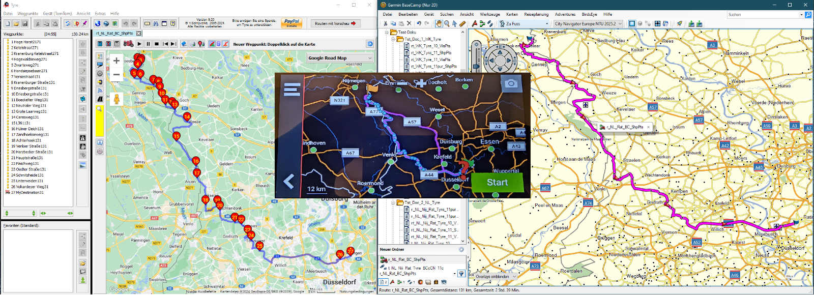

Attached are pictures that show that planning is not the problem.
I can also recalculate over all with other route algorithms without any problems.
Ergo, the route is not the problem,
If the Tread app is causing problems.
PNG-Bild (neu).png (1.24 MiB) Viewed 5904 times

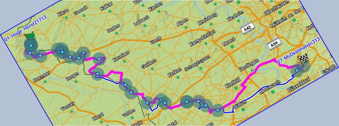

Before Synch - Perfect Route from Basecamp (rotated on screen to get a better view)
(This is two separate screen shots from my phone, spliced together.)
Proof XT2 Map.png (687.56 KiB) Viewed 5789 times

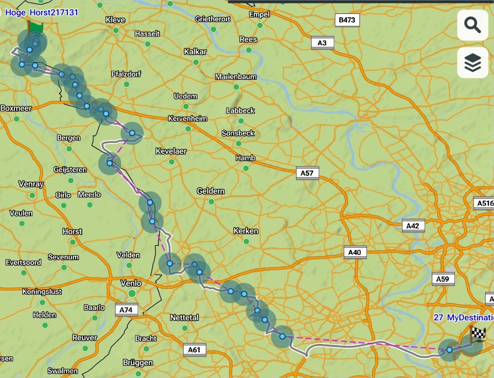

When I allowed it to Synch with the phone - the route was broadly similar, but there were places where for whatever reason, it had chosen a different route from the one plotted. THis route eventually snynched back to the XT2 - so that route was then altered to match the one on the phone (below).
After Synch - the route viewed on the phone (rotated screenshot to match previous image).
Synched Route to Phone.jpg (146.4 KiB) Viewed 5789 times
With the original unsynched route, I tried all 4 adventurous routing options, and although the route changed - especially where there were fewer shaping points, the shaping points themsleves never moved, and the route was calculated between the shaping points - passing through every one in their (fixed) position.
From this It seems that the only alteration to the shaping points takes place when the gpx route on the SD card is sent to the Tread app. This is not a Basecamp thing. It is what I noticed with my test routes and it happens with GPX file that are exported from the Tread App as well.

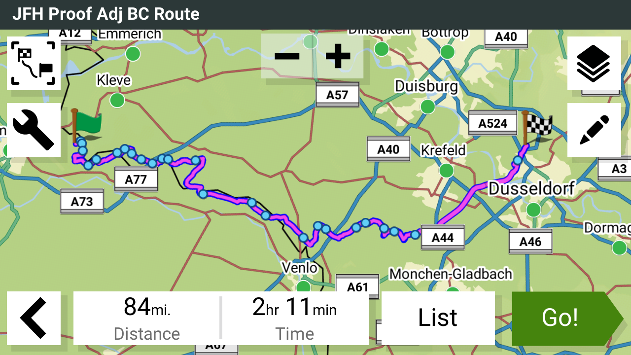

Sending the GPX file to the Tread App
I made a duplicate track and route and named them slightly differently. The two gpx files were sent by email from my PC to my phone. These were then 'opened' on the phone's mail program which prompted a number of Apps which could cope with the GPX attachements. I selected Tread, and that opened up the Tread app, and invited me to create a new collection or choose an existing one.
The resulting route came through very quickly, but it seems to have stripped out all information about the roads to be followed. The shaping points are as planned in Basecamp - as far as I can tell - and the map shows each point joined to the next with a dotted straight line - which is what the Tread App does while it is working out a route. But nothing was happening to this route - it stayed like this for a long time.
Map showing the GPX file after import to the Tread App. Image is two screen shots pasted together. Click for a clearer view.
The blue line is a track cretaed in BAsecamp from the plotted route.
JFH Imported by Email.jpg (225.5 KiB) Viewed 5774 times
When this was allowed to synch with the XT2, the XT2 could not calculate the route.
When I tried to set the routing preference for the route on the Tread App It displays the message "Shaping Point must be placed close to a road or trail".
I know that I have seen this work before. I cannot work out what is happening in this example.
