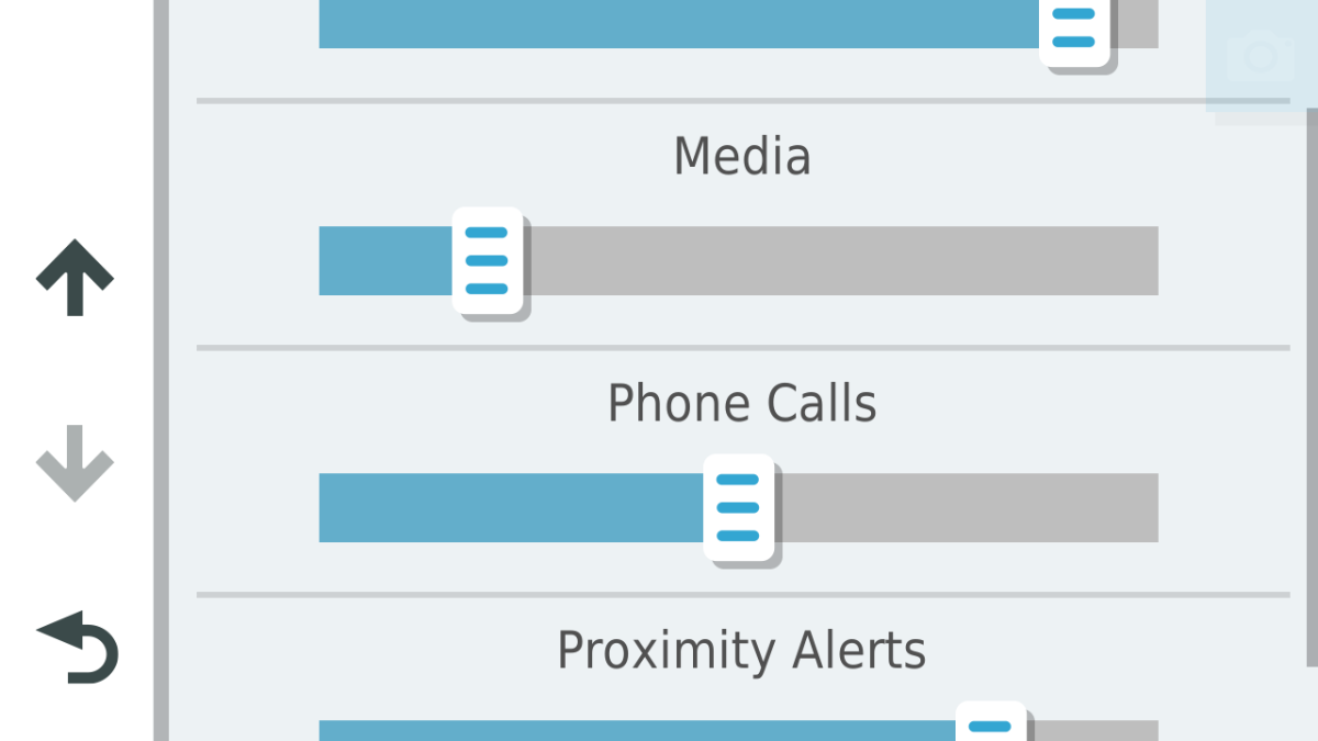

in both cases the sound is much to loud and there is a constantly repeating loud crackling 'krss' (0.1sec) normal audio (0.5 sec) 'krss'(0.1sec) and so on. (timing estimated)
I also think its weird that the 'Phone Calls' volume slider is gone when a Bluetooth headset is connected.
