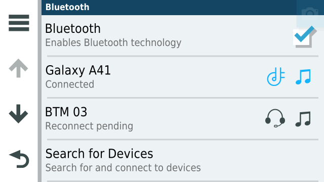

Below, two screenshots.
No headset.png (44.41 KiB) Viewed 2739 times
This one is before I have linked to the BT headset GLINBT18. In fact, Zumo doesn't know about it yet.
Note that my Galaxy A41 phone doesn't feature as a phone. Only Drive and music connections are established.
This is because all phone conversation - speaker and mic - have been linked to the XT and the XT is not connected to a device that has a mic and earphones.
If the phone rings in this state, I probably won't hear it.

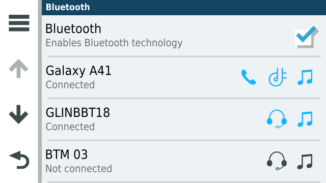

With Headset.png (41.26 KiB) Viewed 2739 times
Here the cheap BT headset has been paired to the XT. It can handle headphone stuff (speakers and mic) and music.
But note that now, the phone has got the phone handset icon. It can now be used for phone calls.
When the XT is connected to the bike, and the BTM03 nodule is paired, the BTM03 icons are blue and the GLINBT18 icons are black. I normally tell it to forget the GLINBT18 device once I have finished testing.
When I turned the GLINBT18 cheap headset off, the GALAXY A41 phone icon went black. ie it knew that it has had a connection, but it could no longer establish it. After turning the XT off and then on again, the phone icon had gone altogether - just like the top picture.
