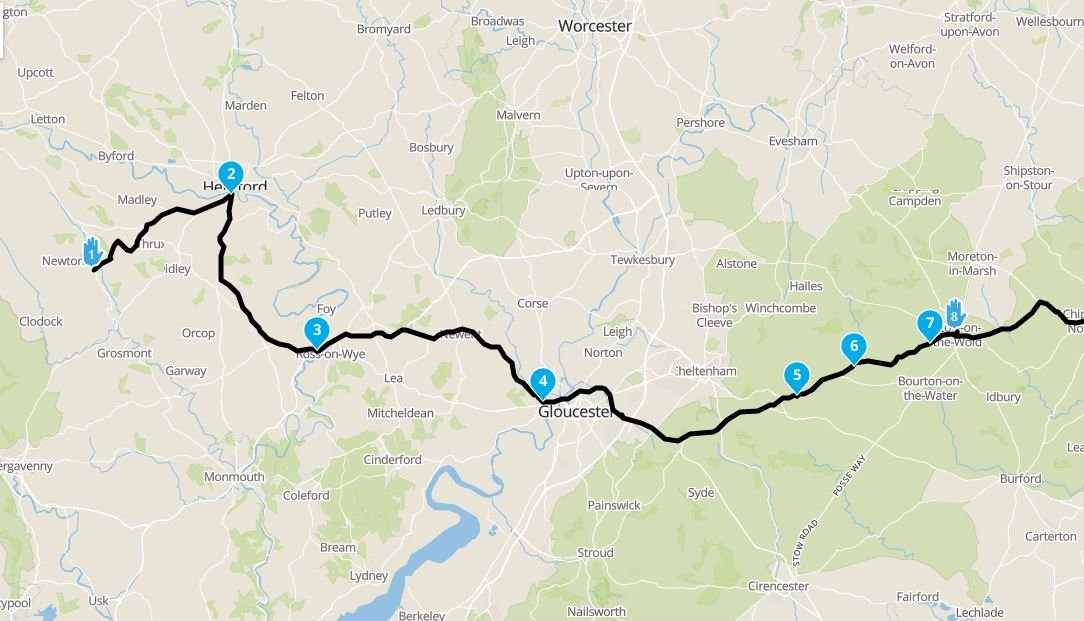

I had the points in MRA set to both Via and Shaping points depending whether I needed to stop at particular places. I guess I need more shaping points to force the XT to take the route I want and not just what it wants.
This is the route I had wanted to take;-
MRA route.JPG (98.1 KiB) Viewed 4724 times
This is the route it took me;-
MRA 2.JPG (109.52 KiB) Viewed 4724 times
When I got to point 8 I gave up trying to follow my route and navigated by memory instead as it seemed to be taking entirely arbitrary routes. So I still don't know why it took a different route.

If you want to post or send me a pm with the gpx file - or share the MRA route (not that I have ever done that yet) - I will take a look.
The XT does seem to go a long way out of its way if there is a main road nearby - regardless of whether that results in a faster time. And around there you have the M4. Your shaping points may need to be placed with that in mind.

I exported it from MRA using Garmin Zumo XT gpx1.2. The XT imported into the trip planner and I started the route from there. When I got to Hereford it was there that it took me towards Ross on Wye rather than towards Tewkesbury as I had intended. When I got to the M50 it wanted me to take that and then rerouted me via Newent and Gloucester. Once I eventually got to Stow I skipped the planned tea stop and it then went haywire. I then took the A436 to Chipping Norton and since it wanted to take me up to Banbury and then probably via Northampton and the A4 I took the road I know through Aynho and to the A421. When I got there it wanted me to go up the A43 so I ignored it.

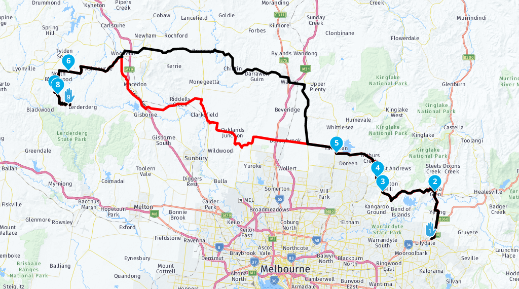

jfheath wrote: Fri Feb 11, 2022 7:56 pm or it could be to do with slightly mis-placed points on the map -
That is a good point. I usually zoom right in on maps after I have created a route to make sure all the waypoints are actually on the road not near the road. I have had a couple of instances with GPS where I get into loops going around in circles because a waypoint was placed accidentally on the wrong side of a divided road and the GPS has tried to make all sorts of intricate turns to get me to the position of the waypoint.
The other thing with MRA is to make sure you are using the correct basemap to plan the route. Routes should be planned using the Here maps not the TomTom Gold or Default (Open source) maps.It is amazing how much routes can differ depending on which maps they are created in. If you import a route created in Tom Tom maps to a Garmin it will change the route internally to suit the Garmin. Depending on which version of MRA you have there may be an option under Toolkit to "Compare route with". This allows you to overlay a TomTom map route on top of a Here map route for example and manually adjust them so they align. I have found this a very handy feature when I have done routes for group rides where people use different brands of GPS it stops the inevitable situation of the TomTom people turning right and the Garmin people turning left and the non GPS people being confused.
Re: Zumo XT not following route
Posted: Sun Feb 13, 2022 9:45 pm
by Richard_R
Here is an example of what I was talking about with different maps in MRA. The black route is what I created using Here (Garmin). The red is what the TomTom map would want to do.
Screen Shot 2022-02-14 at 8.42.25 am.png (713.24 KiB) Viewed 4632 times
Edit:
Just to clarify. If I had planned the route in MRA using the TomTom map the route would have included the red section as there are no waypoints in that section however when the route was loaded into the Garmin it would have directed me along the black line.
