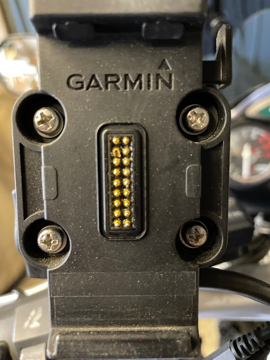

One of the Gold Pins on my Zumo 660 power mount has broken. Does anybody know how this will affect it’s performance?

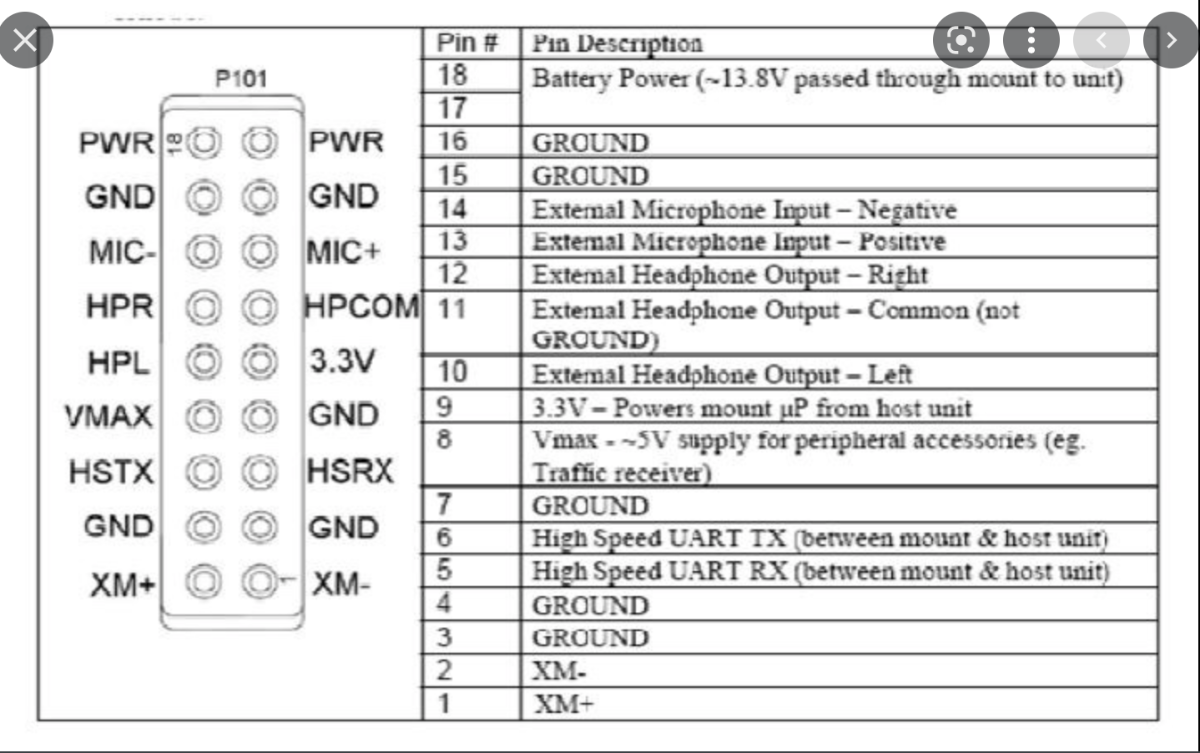

It would help to know which pin. For example, if it's #8 and you don't use a traffic receiver, no harm.

It’s the second pin down on the left hand side (16?)
Looks like it’s a GND connection.
Initially I thought it wasn’t charging through the mount but if I turn on the ‘diagnostic’ mode it indicates it’s charging ok.

There's 3 GND (Ground) pins. Losing one is probably OK.
