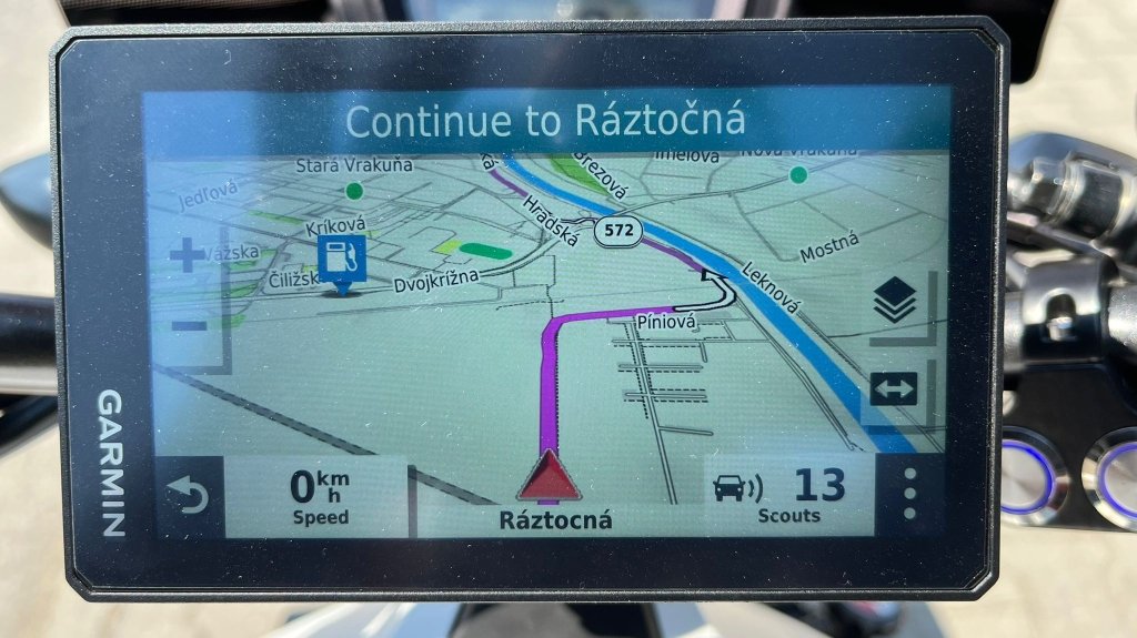

Hello all there, I''d like to describe you mine issue. This is not only mine, more users reported this on FB groups.
On the navigation screen you have blue info bar (ribbon) on the top of the screen. There should be current important infos about next junction, turn, roundabout exit... But I have there empty bar, or just info with the text "Continue on <name-of-street>" or "Continue on road B54". I have all updates, no custom maps, I've been trying to disable layer, topo maps... Only disabling GPS and simulate the trip - than it shows actions correctly.

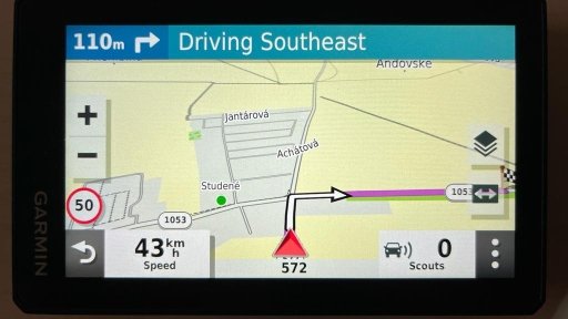

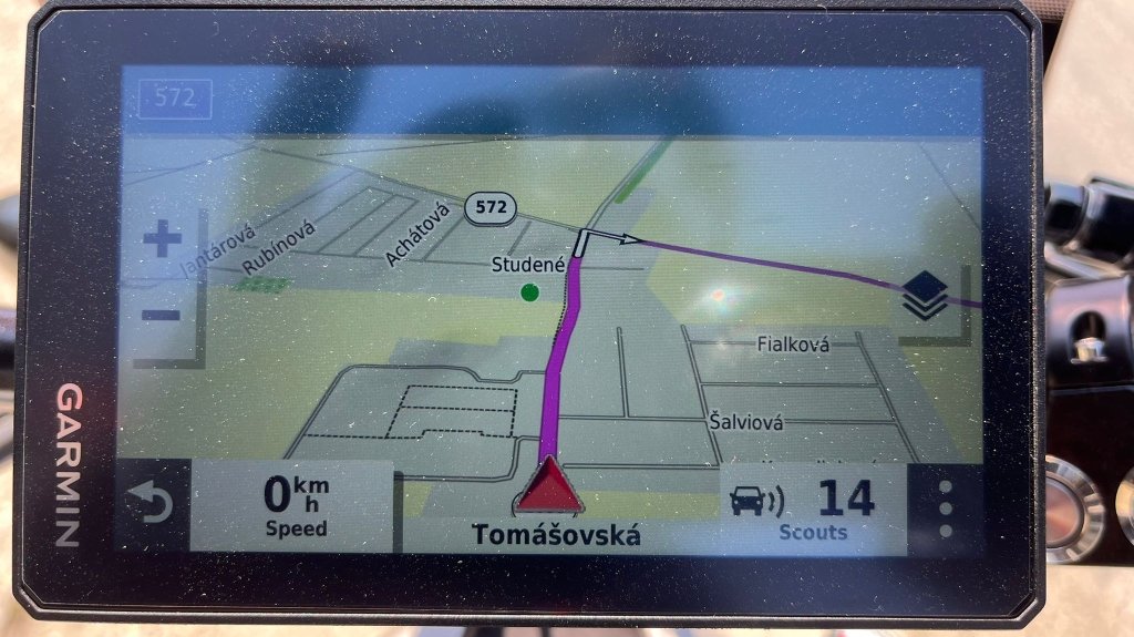

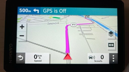

Some example screenshots:
Enabled GPS on Raztocna - only Continue shows:
Disabled GPS on Raztocna - show next turn:
Next example is empty action:
And with GPS off:

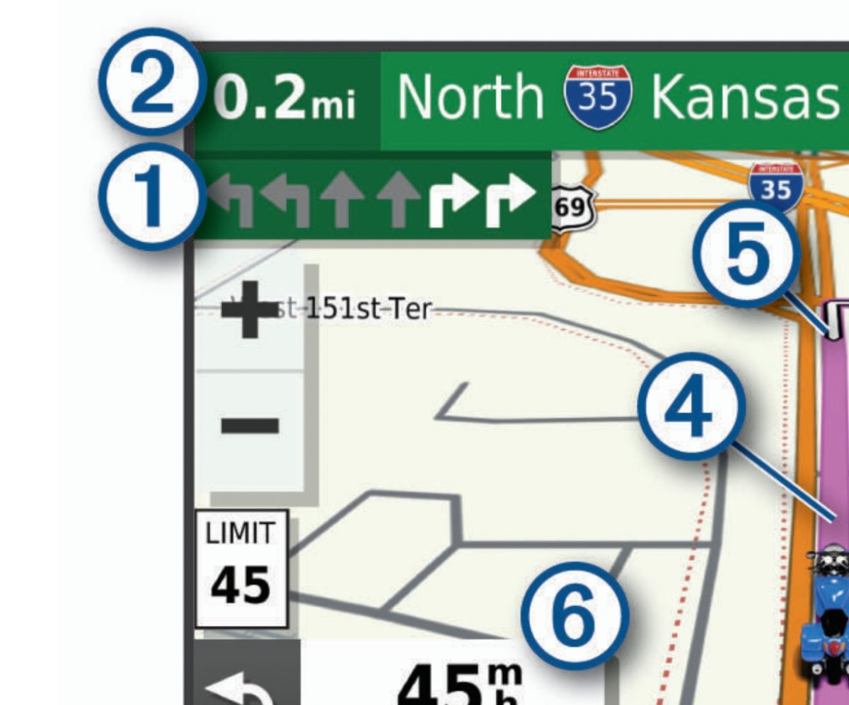

I am now having the same problem since a recent update. I'm not sure if it was an update to the firmware (6.50) or the last map (CN North America NT 2023.10) that caused it.
The upper green text bar no longer shows the next action in the route, 1 in the image below, or distance to the next action in the route, 2 in the image below.
Garmin-next actions.jpg (119.75 KiB) Viewed 4338 times
Has anyone else experienced this and if so how was it solved?

Normally 'Continue to xxxx Street' is displayed when you are NOT(!) on the planned route ant therefor you get no 'next turn info'! These are only displayed when you're on the planned route...
