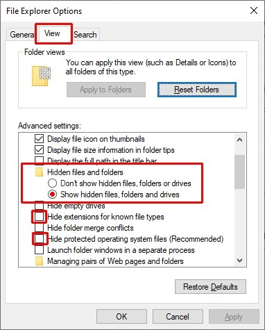

Load Control Panel and select "File Explorer Options" (Which is in Appearance and Personalisation if Control Panel is grouped by Category).
You will see a window that looks like this.
Hidden files.jpg (45.95 KiB) Viewed 6181 times
You might want to make changes to the settings that I have marked in red.
Show the hidden files and folders.
Don't hide the protected operating system files (this may not be necessary - try without if you are unsure).
Untick hide extensions for known file types will always show you the extension - which will help with the map files which use the same name for 2 or 3 files, but each time with a different extension. (Though it makes no difference to the hidden .Systsem file).
This should show the .System file in your file browser - although it is probably still grey - becasue it is still marked as hidden.
Now you can see it, you can mark it as not hidden. Right click the .System file and select Properties. Untick the 'Hidden' check box.

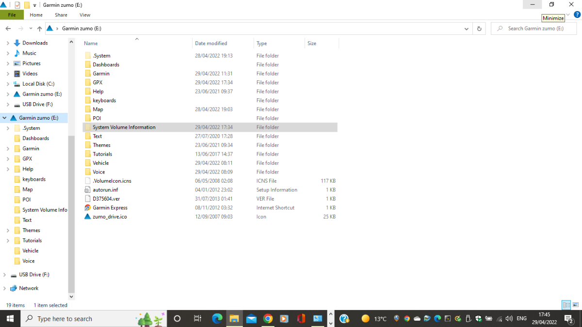

I have done all of the above and as you said it displays two drives, E & F.
The F drive contains the folders mentioned but looking at them there is only one file in there of 2.7ish Gig and that is from the update yesterday.
Hope this makes sense as I am not very computer literate!
I have put a screenshot of the page on.
Screenshot (18).png (203.74 KiB) Viewed 6174 times
download/file.php?mode=view&id=1229

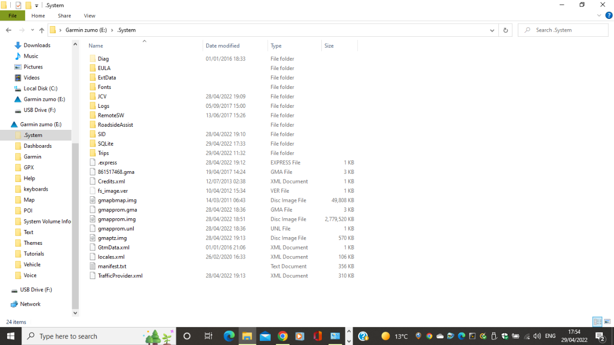

If I open .system this is what I see.
Screenshot (19).png (227.95 KiB) Viewed 6174 times

You may need to compare with someone else who has a 396, but from your data I would suggest that this may be about right.
It would seem that the 396 has only 8GB of internal storage since you have only 179Mb of 7.13Gb. (Whatever the value is for memory (eg 8GB) you get much less than that for actually storing data, once the system has formatted the space to make it usable. Most of it is used for maps and all of the operating system files.
But there is enough memory there for the system to work. If you want more for music or for additional maps, use an SD card.
Some of the files can be removed, but you don't gain much. eg - Voice, Vehicle, Keyboards. There is no need, but if you choose to do that then always take a backup of any folder from which you delete files - just in case you need to put them back.
