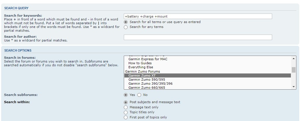

There could be a whole host of reasons for not charging, and there are plenty of posts on the forums. I've added a link to some of them below - which is easy enough to click. But to search for your own stuff to fine tune your won searches - click on the gear icon - top right of the page - and type in the words that you want to search for.
I selected +Battery +Charge and +Mount within the Zumo XT forum. The + is important in this case - it is a logical AND operator - ensuring that the found posts contain all 3 words. A lot of people have complained about the mount which is why I included that word.
See the screen shot. This gives two pages of results (<20 posts). If you right click and open them in a new tab, you'll keep the page containing the links available for other clicks.
