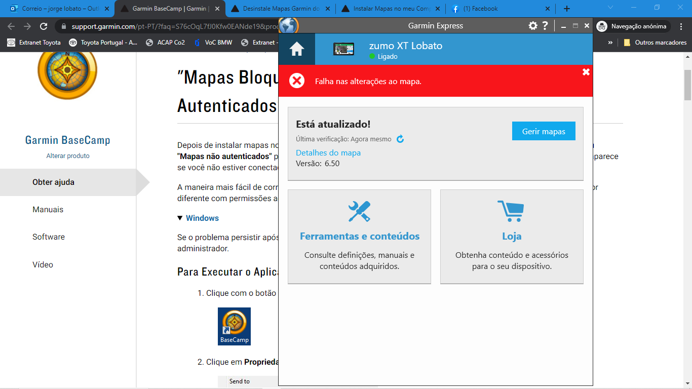

Two weeks ago I successfully updated my Zumo XT to map Europe 23.20 with Garmin Express. When installing the same map on the PC it showed a red message in the end "couldn't perform the changes to the map".
Red message "Fail to apply changes to the map"

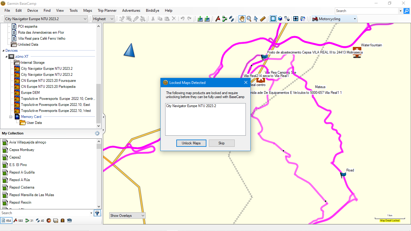

Opening Basecamp, the map was there but said it was locked.
Locked map message everytime I open Basecamp

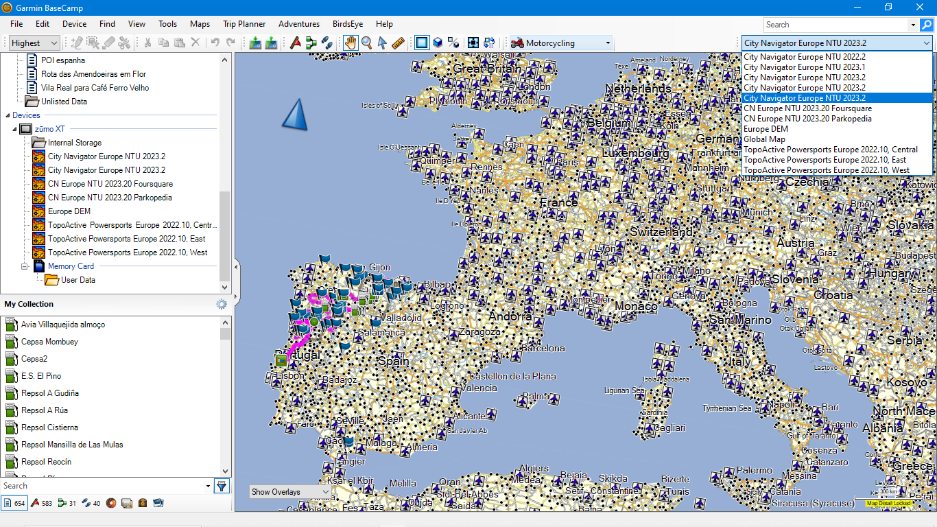

With Zumo XT connected it shows the map divided in two zones, North and South divided by a blue line. I guess this is normal because of file size limit on FAT32. Limit is 4 Gb so it's divided in two 4 Gb files (North and South)
Using 23.20 map from Zumo XT: a blue line surrounds the Europe North. Inside blue line the map is detailed, outside it lacks detail, only shows main roads, like the Global Map
Zoomed area of the same map in Zumo XT to show the different detail between South Europe and North Europe in French/German border
Selection of the other 23.20 map in Zumo XT shows a blue line around Southern Europe and the opposite happens regarding map detail to the Northern portion of the map
Selected 23.20 map installed on PC with no blue line around any Europe zone but message "Map detail locked" message on the bottom right corner.
