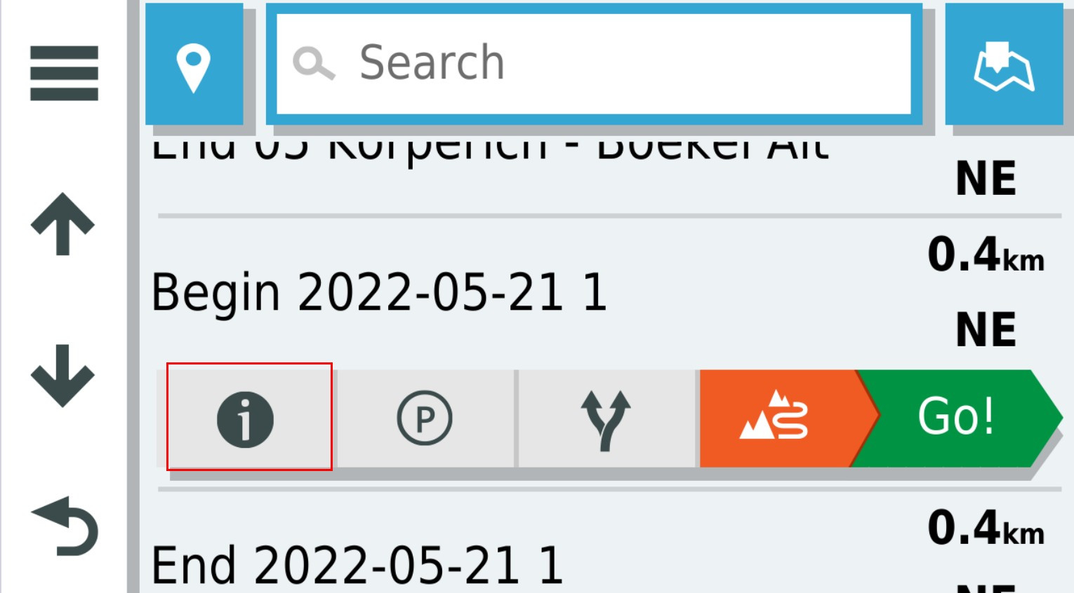

1) Open a Saved location (Where to/Saved), Click on the I Symbol of the location you want.
- Saved.jpg (151.69 KiB) Viewed 5449 times

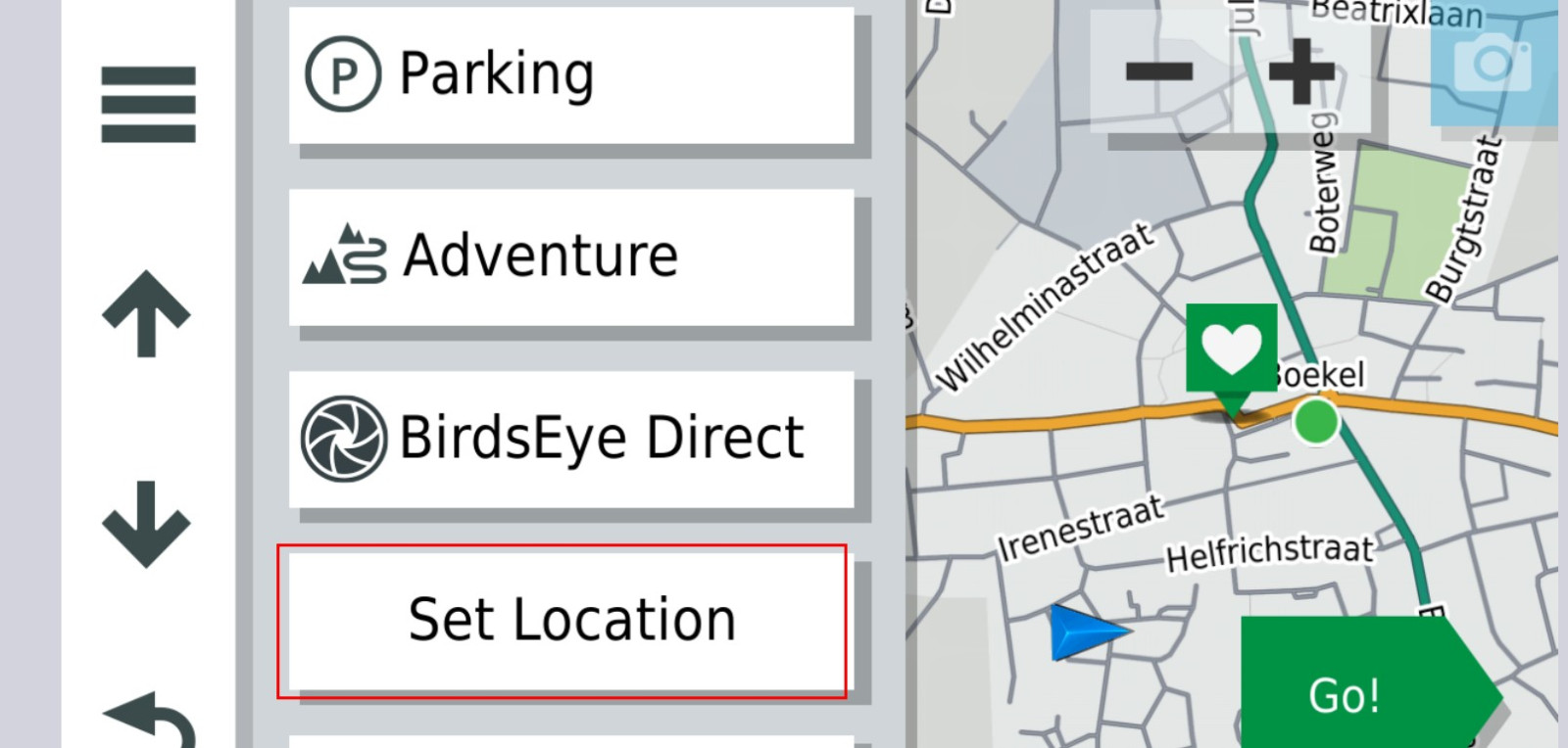

CLick on 'Set location'
- setlocation.jpg (178.59 KiB) Viewed 5449 times

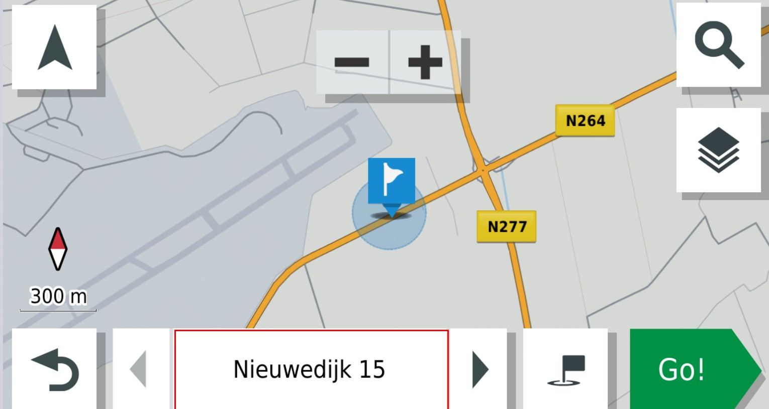

2) From the Map. First Click on a road or point.
Cick on the name of selected road/point (Nieuwedijk 15 in the screenshot)
- Map.jpg (134.76 KiB) Viewed 5449 times
Click on 'Set Location'
Note: The button 'Set Location' appears only when you've enabled the GPS Simulator
