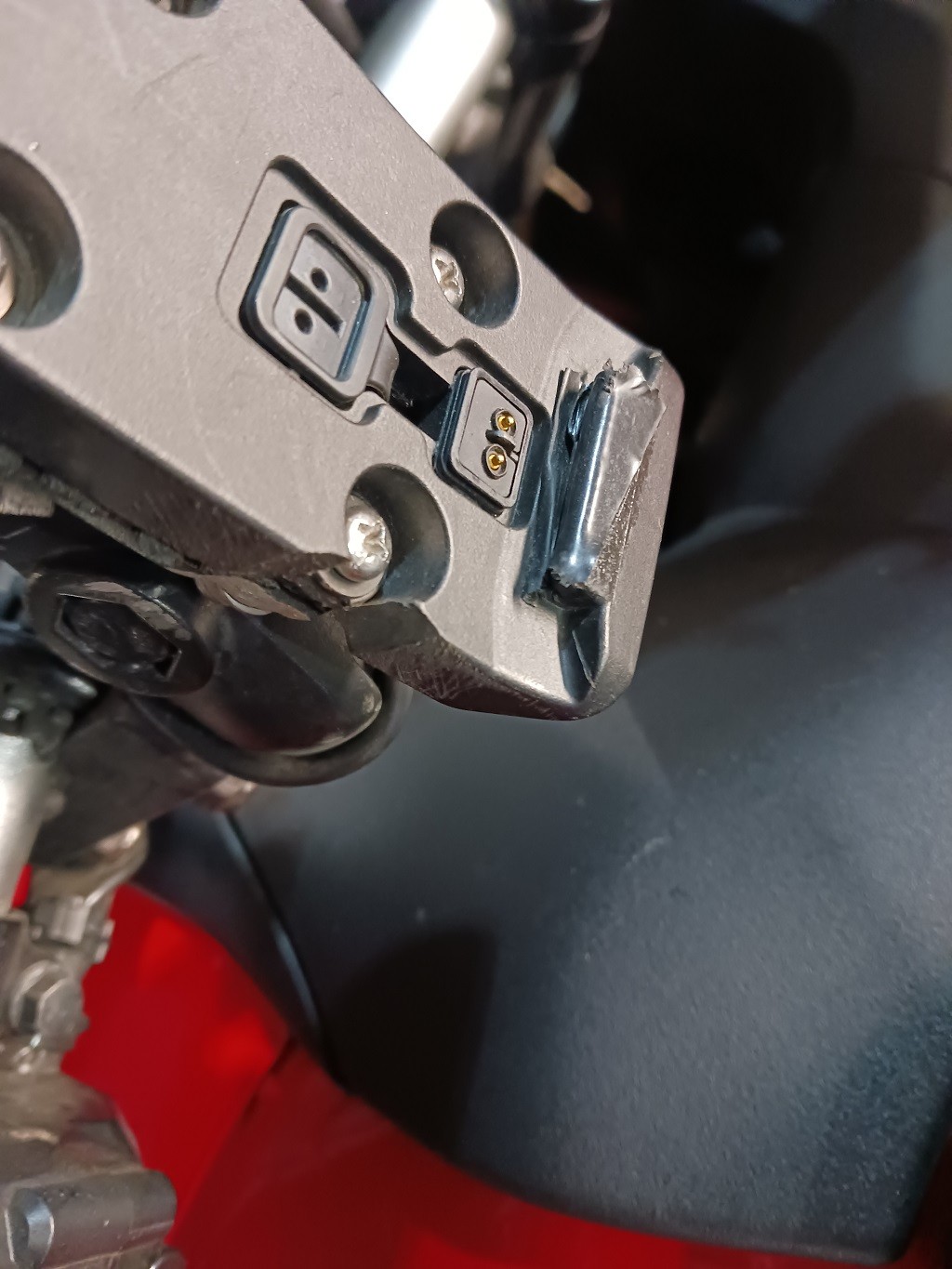

I have a 396, a 390 and a 395 and the Garmin cradle and power harnesses mounted on four different bikes. On three of these cables I was getting frequent "power lost messages" while riding. I have solved this by adding a strip of electrical tape to the cradle opposite the two pin connector to make the connection tighter. I beleive without this shimming the motorcycle vibration causes the electrical connection to be lost.
I suggest you try this shimming, maybe it will solve your problem.

lather wrote: Mon May 22, 2023 3:22 pm I have a 396, a 390 and a 395 and the Garmin cradle and power harnesses mounted on four different bikes. On three of these cables I was getting frequent "power lost messages" while riding. I have solved this by adding a strip of electrical tape to the cradle opposite the two pin connector to make the connection tighter. I beleive without this shimming the motorcycle vibration causes the electrical connection to be lost.
I'm trying to mentally picture where on the 396 cradle you add a strip of electrical tape. I'm soon getting a 396 and want to do that to mine when it arrives. that 2 pin power connector is held in the cradle by a screw from the back of the cradle? where does the electrical tape go?
Re: Starts Up on Motorcycle Cradle But Does Not Charge
Posted: Sat Dec 30, 2023 2:37 pm
by lather
The tape is wrapped over the protrusion on the bottom of the cradle where the slot on the GPS fits. Here is a picture:
Warning: If you add the tape it becomes a bit more difficult to insert the GPS into the cradle and if you are not careful it may not be fully locked in.
Just make sure the unit is fully locked in before riding off.
