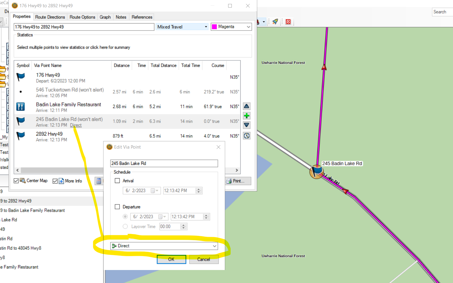

Re: Is this a Garmin map error?
Posted: Fri Jun 02, 2023 4:38 pm
by Peobody
I think this image will be self-explanatory.
BC Direct route point.png (329.9 KiB) Viewed 2520 times
Posted: Fri Jun 02, 2023 4:49 pm
by tombarrington
Brilliant! Works perfectly on BaseCamp. Hopefully, it will show up the same on the Zumo. Thank you!
Posted: Fri Jun 02, 2023 4:57 pm
by Peobody
Wow, that turned out better than I expected. Please post back once you preview it on the XT.
