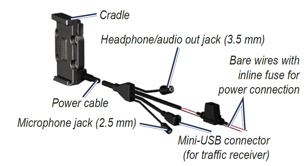

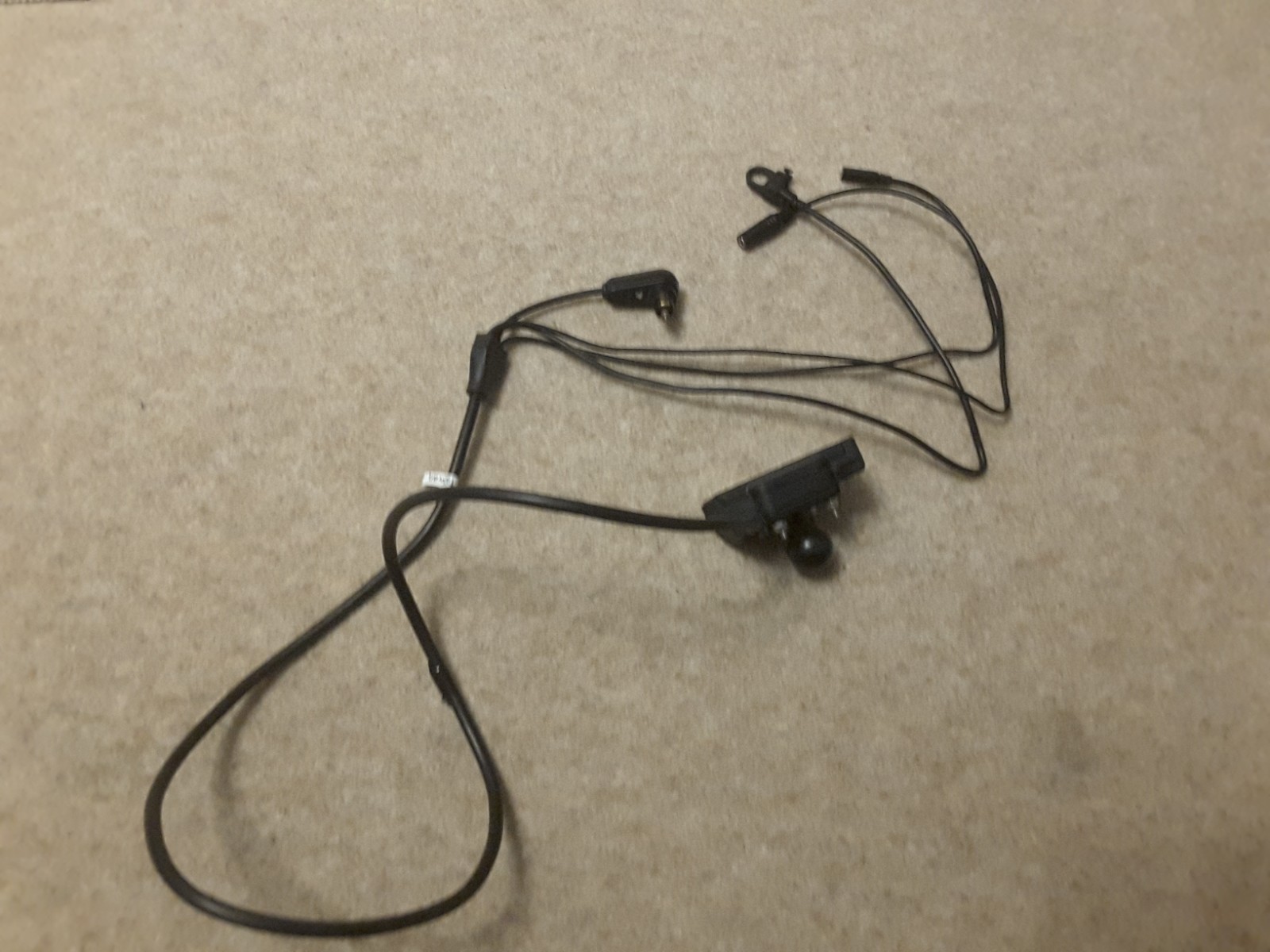

I bought my 550 many years ago (well it would be wouldn't It! :D ) for use on my Triumph Tiger 1050. I only used the Powerlet connector and the others for Audio Out, Mic In and an unknown one were taped together and the cables looped together and taped to shorten the overall length. This was Ok on the Tiger as there was a decent run between the sat nav and the power outlet and the bulky cable sat in the part fairing.
I've swopped the Tiger for a Triumph Scrambler 1200 XE and fitted the power outlet and mounted the sat nav and it works fine. The cable is far too long though and I want to lose all the connectors that I'm not using. I assume I can cut those off adjacent to the block? There is a thicker cable going into the block which I'm assuming contains all the cables bundled together? Ideally I'd like to do away with that block and reduce the cable length. Anyone know what the cable with the unknown termination is?

The 660 cable looks like this
Zumo660 Wiring.jpg (84.84 KiB) Viewed 3372 times
I wouldn't go trying to separate any of that little lot. You will regret it.

This article https://motorcycleinfo.co.uk/garmin-zum ... index2d35/ describes taking a pair of cutters to the cabe and shortening it. Assuming the 660 cradle is similar to the 590/595 there is a better way if you're comfortable with very fiddly wiring. It's described here:- https://jahonen.kapsi.fi/Electronics/Ga ... le_cradle/

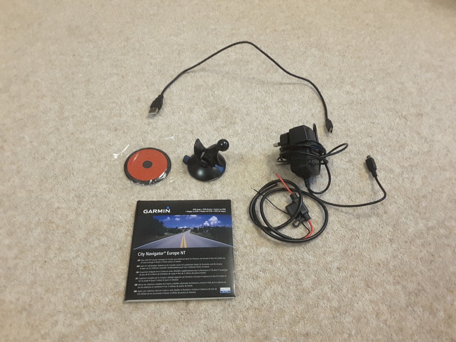

But it sounds as though Mapsource (thanks Les) is favourite though? Need to find a safe source to download it from and may have a problem as I don't have an existing copy. I do have the original Garmin City Navigator Europe NT disk which may have Mapsource on it but may have a problem with the unlock code which was probably emailed to me from Garmin? I see there are workarounds though.

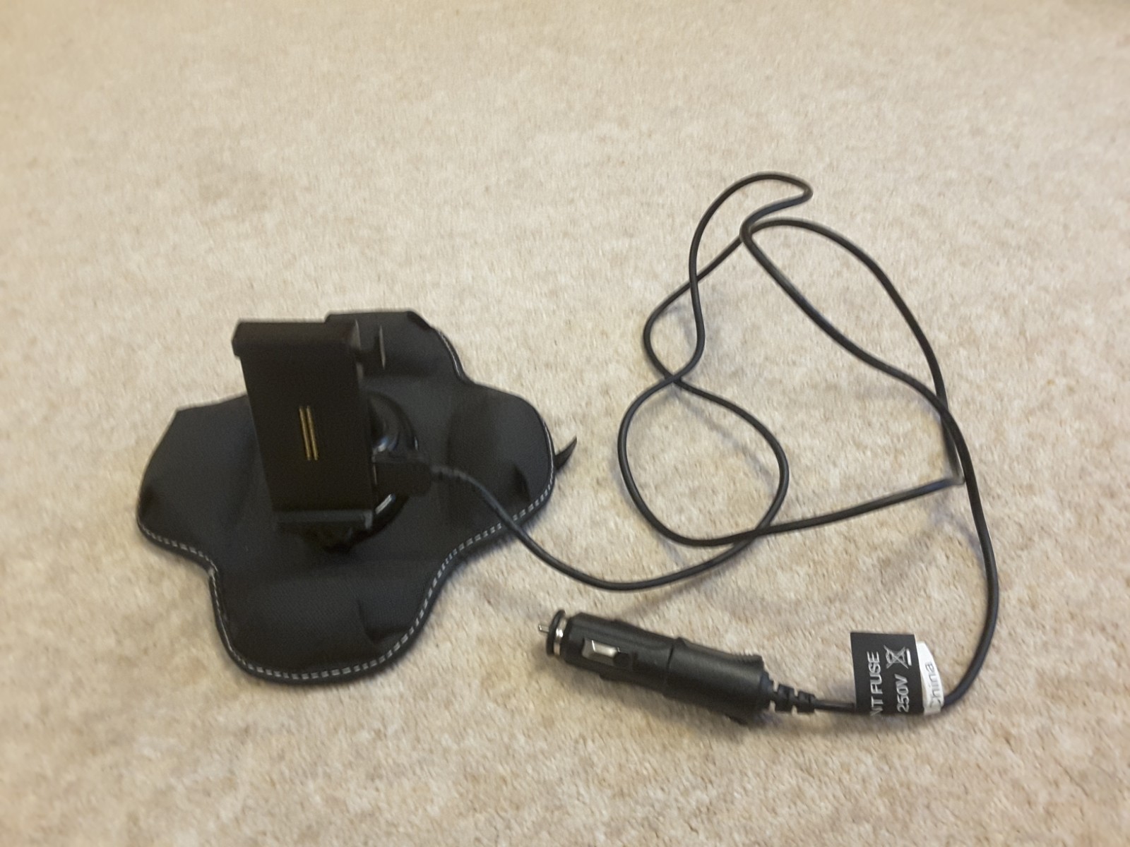

It was good to find the original box with the stuff including the invoice. Motorcycle sat navs are always more expensive and the 660 certainly was as it cost me £435.71 from Halfords in July 2011. Having said that though you got the 660, the mount and RAM accessories to attach to the handlebars, cover, USB cable, charger and the mount for car use so it wasn't too bad.
I did use the 660 in a couple of cars but didn't want to use the supplied suction mount so bought the bean bag type mount which sat on the dashboard and worked well.
As said the 660 is a nice and well built unit and I look forward to using it again. Some say that TomToms are better and newer units may have improved features but the 660 does what I want and I like it.
Bear - thanks for the links to the cable modifications, just what I was looking for. I have heat shrink etc. and it wouldn't be a problem for me but still hesitant about attacking a perfect cable! Had a look on EBay for another cable and the prices are wow for what is now an old device!
The cable from the car mount would be ideal as it only carries power!

Here is my cable with the Powerlet fitted. Way too much cable and bulk for my naked bike! You should just be able to see the tape which marks all I need now!
