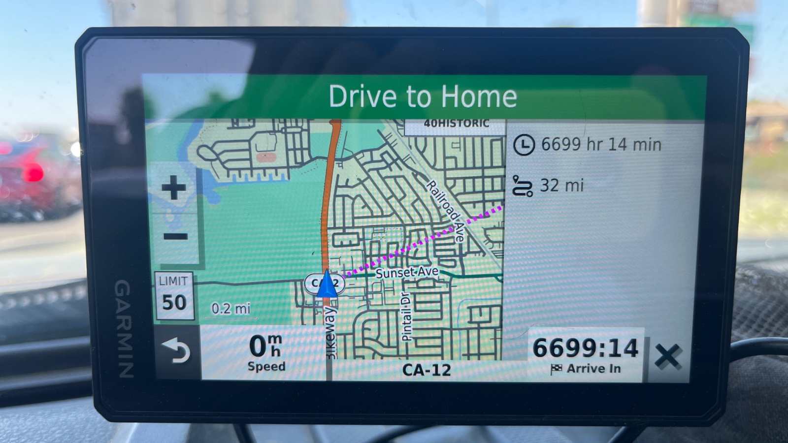

Hello All,
First post on this forum.
I just returned to the San Francisco Bay Area after a trip to the eastern Sierras.
All was going fine on the way there. On the way back this morning, I tapped “Where to” and then “Home”. The Zumo calculated the trip and provided the answer of 6,699 hours and 14 minutes. There was a burgundy line extending from my vehicle to somewhere off the west African coast (Nigeria).
I tried everything, changing various navigation preferences,vehicle types, off-route calculation preferences, etc. Nothing helped.
And, for what its worth…and to no surprise…there were no turn by turn offerings.
Any thoughts on what happened, or what I should do? This would not be good if I was in an unknown place.
Thank you.
David

When the erroneous time appeared, was the displayed position and the 32 mile distance correct?
