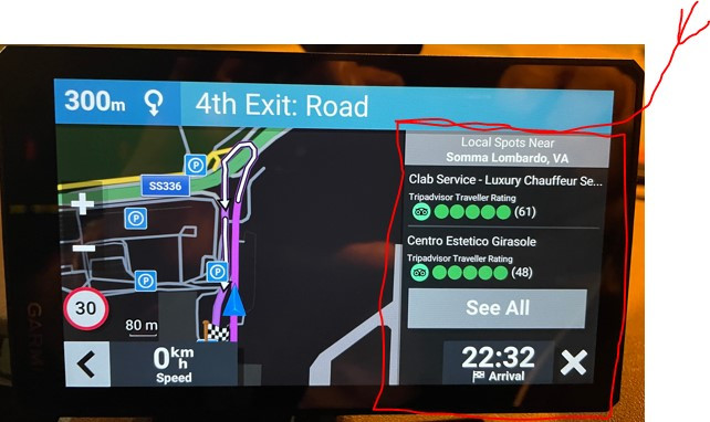

This was photo was taken of the screen last night when I was attempting to safely navigate around the Malpensa Airport Arrivals / Departures zone, in the dark and with significant other trafic in a very confined area with intricate road markings.
On arrival at the destinatioto n, the Zumo XT2 takes over about 30% of the available screen to show completely uselless Tripadvisor advertising – presumably Garmin gets paid by Tripadvisor for this feature.
So, put yourself in the driver’s position:
1. Unfamilliar environment.
2. Considerable traffic.
3. Restricted area with intricate road layout and lane marking.
4. Darkness, with a lot of moving and flashing lights.
Zumo XT2 Tripadvisoe at destination arrival.jpg (70.96 KiB) Viewed 9459 times

Just at the critical time of arrival, when the maximum concentration is needed on traffic and driving, the XT2 takes over 30% of the screen with junk information – I already knew why I was there (to pick up an arriving passenger): I did not need to be offered a Luxury Chauffeur Service or a Health Spa!
The options Garmin thus forces on the driver are to:
A. Try and ignore the unessary distraction and work with the small map window – why buy a big screen device just to receive advertising from Tripadvisor?
B. Switch attention away from the road, take one hand off the bars and dismiss the XT2 advertising window – in case of an accident caused by the distraction, will Garmin accept the liability in court?
These options are both unsafe and unreasonable.
Had I known of this “feature” I would not have purchased the device because this “feature” creates a very real safty hazard.
I assume that it should be possible to either supress this feature (in which case how?) or to completely remove Tripadvisor from the device (in which case how?).
So far Garmin support (usually very good) have not responded to a support request so do any of you guys know how to kill this spam feature on the device?

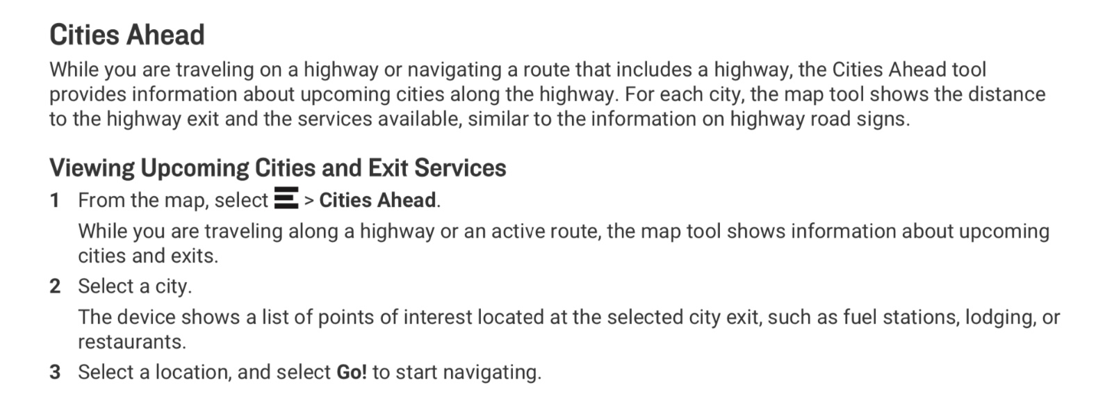

You could turn it off to see if that makes it go away. If it does, then turn it on again and see if you can configure it. Look at Cities Ahead - the XT doesn't have that but I found this in the XT2 manual.

Many Thanks, I've configured UP AHEAD to only show Garmin Red Light Cameras, Parking and Roadside Services and this works fine on the journey. However, it does not seem to affect the Zumo XT2 popping the TripAdvisor window on arrival.
It seems as if the Tripadvisor is able to overide these settings at destination arrival.
I'll try disabling UP AHEAD completely to see if it makes any difference.
I've had an overnight answer from Garmin Support as follows:
Looking at this it appears to be the 'up ahead' details. You can turn this off simply by tapping the 'X' in the bottom right corner. That gets rid of the box and should keep the screen free of clutter upon approach to your destination
Alternatively you can customise it to make it more useful and less Advert-y by changing the categories utilised -
Customising the up ahead categories
First Garmin Suggestion - This does not work - Tapping X removes the window for the single instance, but does not stop the Tripadvisor window popping at subsequent Destination arrivals. The biggest irritation at Malpensa Airport Arrivals / Departures was that as the road system takes you in concentric circles in a small physical area every time I passed the location that Garmin recognised as the Destination the Tripadvisor window popped again!
Seconnd Garmin Suggestion - Supports your analysis, but it seems impossible to select Tripadvisor out (software overide?) so I'll try turning UP Ahead off completely to see what the effect is. Should be able to do this today and will post an update this evening along with any update from Garmin.
