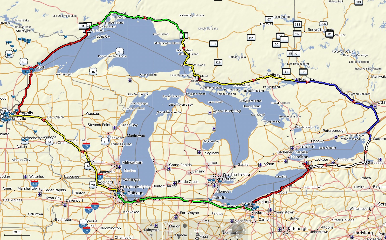

Mostly all I use Basecamp for now is to pull the tracks after a long trip.
I wanted to map out my 8-day trip in an overview, and there's no easy way I know of to pull that data with any other software.
