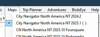

On my PC, the Maps toolbar dropdown shows three copies as shown in Craig's post, but the Maps menu does not show the location of the map, or that there are multiple copies available. The options from the menu only show one instance of the map, with empty parentheses after it when the XT is connected.
- menu.jpg (15.68 KiB) Viewed 4597 times
At some point long in the past, Basecamp did ask if I wanted to use the faster computer copy in all cases and I agreed, so someone who said NO might see different options.

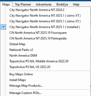

This is what mine looks like with the XT connected.
- pasted.png (67.79 KiB) Viewed 4591 times
Yes, I still have the old map installed. I keep it until I have high confidence in the new one.
lkraus wrote: Sat Mar 30, 2024 8:14 pm
In that popup window there is a "Remember this choice" option. FWIW, the map list does not change when the active map is on the XT. I suspect that the "Remember this choice" option just disables that popup when you switch maps but I don't know for sure.
