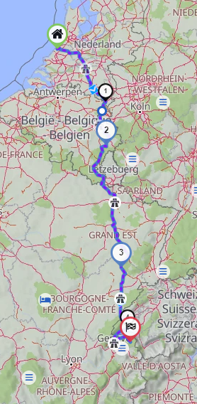

I will use this as an example:
Netherlands to Lake Geneva; in Kurviger it is 987km
GPX file also attached exported from Kurviger
When imported in to Explorer the route looks like this on the map:
Welll..... Garmin Explore isn't working...

Re: Planned distance not making sense
The issue with the mileage is quite common. In order to speed up processing, the software tends to take shortcuts, and doesn't actually re-calculate the entire route unless you specifically ask it to.
Also Kurviger plots a route that is made up of straight lines, rather than one which follows the roads. When you use it, it follows the roads, but that isn't what is recorded.
However, I am unable to explain why there is such a massive discrepancy between Kurvigers figures and reality.
Put that route and track into Basecamp and you get much more realistic figures.
Are you familiar with Basecamp ?
I have recreated the route in Bascamp. It took me about 25 minutes - but that was because I was recording a video of the screen and commentating. It could be done in 5 mins.
Steps.
Create a new list folder
Create 2 new lists in the list folder. Call them Route, Track.
Copy the gpx file to the Route list.
Copy the track to the track list. - drag and drop from the route list
Copy the start and finish point to the track list.
Now work just with the track list.
Change the colour of the track. - I used Cyan - light blue.
Select the start point. Hold Ctrl, select the end point. Create a route from the selected points.
Then it's a matter of using the insert tool to 'rubber band' the route to the roads where the track goes.
You put the new points onto the roads you want to be on after towns, junctions etc. Usually one point in the middle of a section of road, or two points at 1/3 and 2/3 distance works well. Not just after a junction. Otherwise, BC will probably visit the point and then double back. The Zumo will definitely do that !
I got a route with about 12 points total. I added a new waypoint with the flag tool at the cafe stop, and added that to the route.
I made a video of me doing this - but it's not very polished. It took about 25 mins, but took only 5 mins on the practice run. I was trying to explain too much. I'll redo it if you want, keep it punchy.
The mileage is much more consistent. It got it wrong at first, but the route needs recalculating to get it right. When transferred to the XT the mileage was 3 miles different from Basecamp's figure. Basecamp uses more precision in its lat/long coordinates than the XT. 600 miles, little differences can add up. 3 miles is only 0.5%. Oddly, the track mileage and the route mileage were slightly different, and they both plot identical points.
I couldn't work out what Kurviger was doing. That was literally miles out. It causes so many issues for Zumo users. Every point is made as a waypoint - a favourite. But then it creates a track with massive spikes in speed so it has seems to have issues with its distance/time calculations. My guess is that the programmers are not mathematicians. If they were they would know the problems of dividing very small numbers with very small numbers. Especially when the numbers have truncation or rounding errors. Very unreliable results. Anywhere between zero and infinity is possible.
