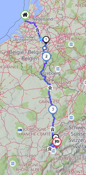

I use Kurviger for my route planning, the Garmin Explore is quite unreliable!!!
I will use this as an example:
Netherlands to Lake Geneva; in Kurviger it is 987km
Screenshot 2024-05-21 131647.png (356.98 KiB) Viewed 3919 times
GPX file also attached exported from Kurviger
When imported in to Explorer the route looks like this on the map:
Welll..... Garmin Explore isn't working...
