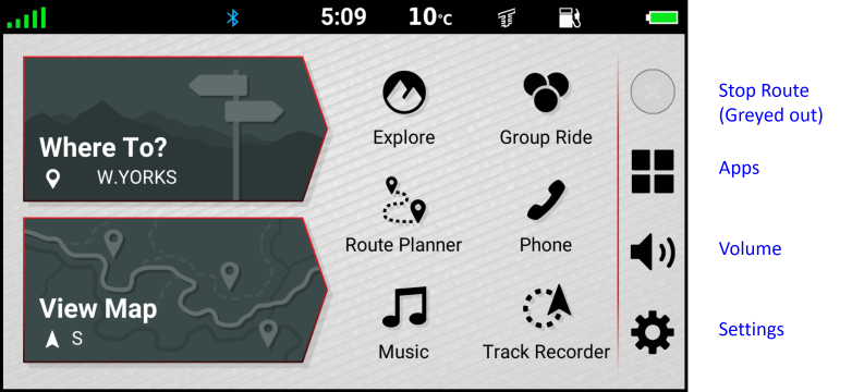

Re: Zumo XT2 : First Impressions
The XT2's main screen layout contains the same set of icons with the top four entries to the right of 'Where To'?' being new additions.
The XT2 looks much bigger than the XT - but the case is just 1cm wider. But the visible display is about 21% larger.
The presence of the Explore icon is initially alarming - but so far it is brilliant. Out of the box, the XT2 has all of the tools that you need to manage 'Collections' - which can be used to organise tracks, routes, courses and waypoints and to enable / prevent their display on the XT screen.
eg Organise everything for one day in one collection.
The Tread App on the phone comminicates traffic, weather, and digital data such as email and message alerts to the XT2. (This has taken over from the XT's Drive App.) This can be set up without having the XT2 synch to the Explore database. The Tread App for the phone also has route planning facilities, but so far it doesn't look to be anything to get too excitied about. But I have yet to enable the Synchronisation.
The XT2 cradle is a similar design to the Zumo XT, but the latching is firmer, requiring a good push and a reassuring loud click as the latch snaps into place. The XT2 will fit in the XT cradle and feels to be just as secure (and actually feels more positive than the XT when pushing the XT2 into the XT cradle). However, the Zumo XT will not fit into the XT2 cradle - this is to do with the locating ridges.
The USB cable is short and is of the USB 'C' type - an oval connector as used by many devices now - but the supplied connector does not provide enough power from a 2.1A wall socket to charge the Zumo XT2 when the screen is on. But it does delay the drain of the battery when using it away from the mount. (This was true of the XT as well - I have had the XT battery go flat when I have been using it and it has been plugged into the wall socket USB outlet).
The above may be the reason that the XT2 is a motorcycle only device. There is no car or off-road profile, and the unit is not provided with a car cradle - although it retains the inbuilt speaker for use when not on the bike.
The XT2 has no inbuilt fuse or step down transformer in the cable. It comes with a separate fuse to use when you wire it into the bike. I didn't bother - my accessory wiring is adequately fused. There must be a transformer - but it is either in the unit itself, or in the mount - which now comes pre-assembled.

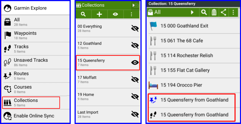

The Explore Icon
Nothing to be wary of here. This opens up a new way of managing the tracks, routes, courses and waypoints on the Zumo - terms which we are familiar with if we have dabbled with Explore on the XT, but what I can only assume was an experiment on the XT, now seems to be a fully-fledged solution for organising routes, tracks and waypoints no matter where they were created. And unlike the XT, it doesn't need to be synched to anything to use it.
For these screen shots, I have not made the link between the XT2 and the Explore database.
Click the image to see a larger version.
Collections
The screen on the left of the above image is actually obtained by tapping the green bar on any of the Explore screens - and shows what kinds of data are managed by this utility. From here I selected collection.
The next images shows the collections that created - 1 collection for each day of a small tour that we did a few years back. 15 would have been the 15th September. Note that Queensferry is the only entry that doesn't have its eye icon (eyecon ?) crossed out. Only the queensferry tracks and waypoints will show up on the map.
The next image shows all of the data items that I have placed in this collection. The Exit - the first Via point to pass through after setting off, 3 cafes, the final hotel, a route and a track. All collected together in one place.
At the top of the previous image is a colelction called '00 Everything'. As well as belonging to a collection like Queensferry for the day, I have added everything to the my Everything Collection. I didn't need to - there is an option to show 'All' in the first screen !

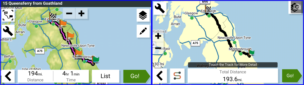

The above image shows the route screen and the track screen. The track screen is shown on the right. On the left is the route screen, showing the magenta route, the start, finish, three Via points and a couple of shaping points (small blue discs). But it is also showing the track peeping out under the route.
Route and Track Together
The above image shows the route in progress (under simulations on the XT2). Out of the box, the route and the track are the same width, and you rarely get to see it to confirm that it is there. I have edited one of the standard theme files to make the track wider. I took a copu of the United Kingdom theme and edited it in notepad. The changes in the top box are at the start of the file. The changes in the bottom box are located near to the bottom of the file. 3.00 might be a bit wide. I've used 2.00 in the past on the XT and it is not quite enough.
What I haven't mentione in all of the above - all tracks and waypoints can be sorted into different orders. By Name, by proximity (where appropriate); latest first. I get round the lack of ability to sort by date of trip by including the date in the name.
