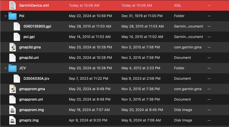

I updated my Garmin maps with the 2024 map.
I am currently traveImageling around Europe (now in Belgium) and my Zumo just went a bit nuts:
it sent me off on side roads, then stopped giving me audio info.
I got a response from a user on the Garmin forum that recommended I delete the most recent Euro map updates, but I am not sure which files those would be. These appear to be the most recent updates, with the most recent dates, but don't want to delete something critical that I cannot get back.
I'm not sure which of these I should delete?
files to delete.png (81.85 KiB) Viewed 5201 times

I notice the maps on your image are gmapprom (3 different files calle gmapprom.xxx - the image, the unlock code and the gms file go together). But usually, this is the second map file that is put on the SD card. There will be another one called something like d98765432a.img (and the associated unl and gma files.) Probably in internal storage.
You might have a few of these numbered files (any with identical numbers are part of the same map - usually three as described above).

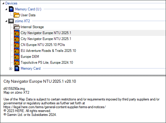

I cannot tell you which is which - but if you have Basecamp, that can tell you. It lists the maps that you have installed on the left hand side, and if you select the map, the bottom pane tells you the file name.
Map identification.png (34.25 KiB) Viewed 5197 times
