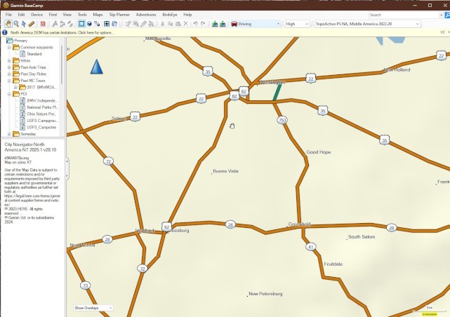

ic0n wrote: Thu Jun 27, 2024 12:26 pm No, it just happened to be the only one listed under the 'Maps' menu one that had the little roads on!
That's interesting as my TopoActive map only shows major highways in Basecamp, which will not display the "topo" content of the map.

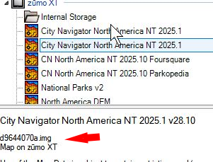

However under the zumo XT device in the left hand pane it adds 'City Navigator Europe NTU 2025.1' - listed twice. Once selected they cover different bits of the world, but it's not evident from the name (as they're identical).
If you select the Zumo CN maps on the left, you'll see the actual file names in the bottom left window. The maps are split up into multiple files because they are too large to fit within the FAT32 file size limit of 4 GB.
Follow the advice above and use Express with the XT connected to install the City Navigator map on your computer. It will all be in one file and you can use it without the XT being connected. Panning and zooming the Basecamp map window will also be much faster.

So if I plan the route using TopoActive Europe West in Basecamp and transfer it to the XT, it 'knows' to use this map for navigating?
Re: Does my Zumo XT have to be plugged in to plan routes?
Posted: Sat Jun 29, 2024 5:01 am
by sussamb
No, it'll use whichever map you have selected. Bear in mind having 2 routeable maps covering the same area will cause issues.
