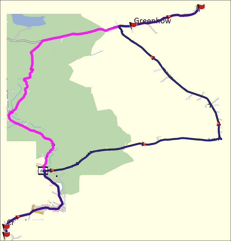

First the route. My original route has been hijacked as the XT2 does not calculate the same route as the XT. My replacement route (local) was also hijacked because it involves a road that has been closed since January, and only reopened 3 days ago.
The proposed Route
RUT Test Map.png (126.37 KiB) Viewed 3911 times
The purple line indicates the route that I will be taking according to BC this is 19 miles 31 minutes.
The blue line is the route that both the XT and XT2 calculate. According to BC this is 21.6 miles and 32 minutes.
There is a starts and and end point and a couple of intermediate points. The first intermediate point is less than half a mile after the start. I intend to skip this point as that forced the XT to recalculate the entire route. Any deviation after that and the route behaved completely differently and would initiate repeated U turn requests until if got less than a mile from the original route.
The routes separate and rejoin without encountering any additional route points - in other words they are free to choose whichever route is best.
The area in between to two routes has no roads. So it has to choose one route or the other - it cannot find a different solution. This mirrors my original tests when I first diagnosed the issue on the XT.
The 4 Via points have all been created as Waypoints.

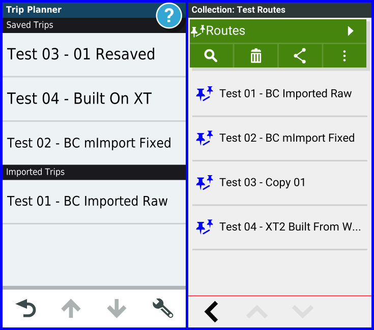

The Tests - XT routes on the left, XT2 Routes on the right.
Screen Tests.png (81.62 KiB) Viewed 3910 times
Same route installed on each device, but the route has been prepared in different ways.
  • 01 - A route exported direct from Basecamp as is. Typically this route would show RUT behaviour under the circumstances described.
  • 02 - The same route duplicated, but given a different name. This has had its mImpoted byte changed to false - so the XT thinks it has been saved, rather than imported.
  • 03 - Test 01 route has been loaded and resaved on the XT, and simply copied on the XT2. In both cases it has been given a new name. The suggestion is that the Zumo thinks that these routes are not imported, and will treat them differently.
  • 04 - All of the via points were created as Waypoints. This makes it possible to create a route using the Zumo screen using the identical route points. So this will be test 04.
The tipping point is about 3 miles after the roundabout where the two routes split.
And that's it so far. I'll know more when I get out on the bike.

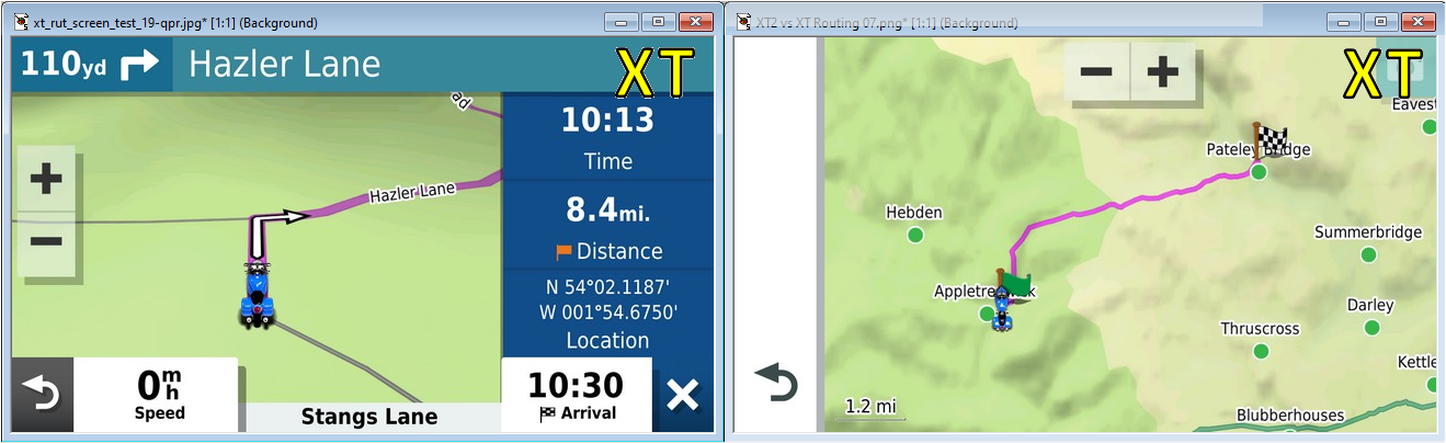

Image 1. Just started route. Note that bottom centre there is a green flag and two orange flags. The green flag is my location.
The first orange flag is the start of the route.
The second orange flag is a via point that I intend to Skip.
The only other plotted points on the route are the last orange flag via point and the finish flag.
XT2 vs XT Routing 01.png (719.14 KiB) Viewed 3728 times
Conclusion - Both routes are the same at this point.

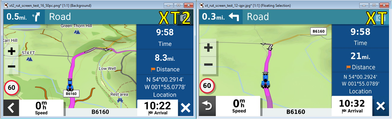

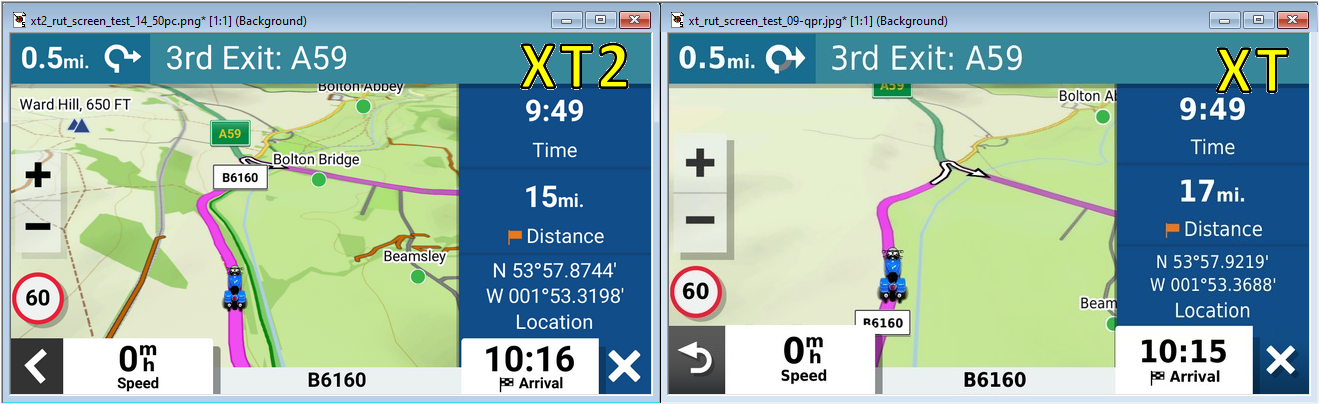

Image 2. 2 miles. I passed through the start point, and I stopped briefly to press the Skip button. This is about half a mile later - I stopped in a lyby after the skipped point to see what had happened to the routes on both devices.
Note that in both cases, the orange via point flags have gone. There is no magenta route behind me. The green flag marks my current position.
Up ahead the route is still heading East (ish) along the A59 before truning north. The orange Via point and chequered flag are both in place.
XT2 vs XT Routing 02.png (730.3 KiB) Viewed 3727 times
Conclusion - Both routes appear to be the the same at this point.

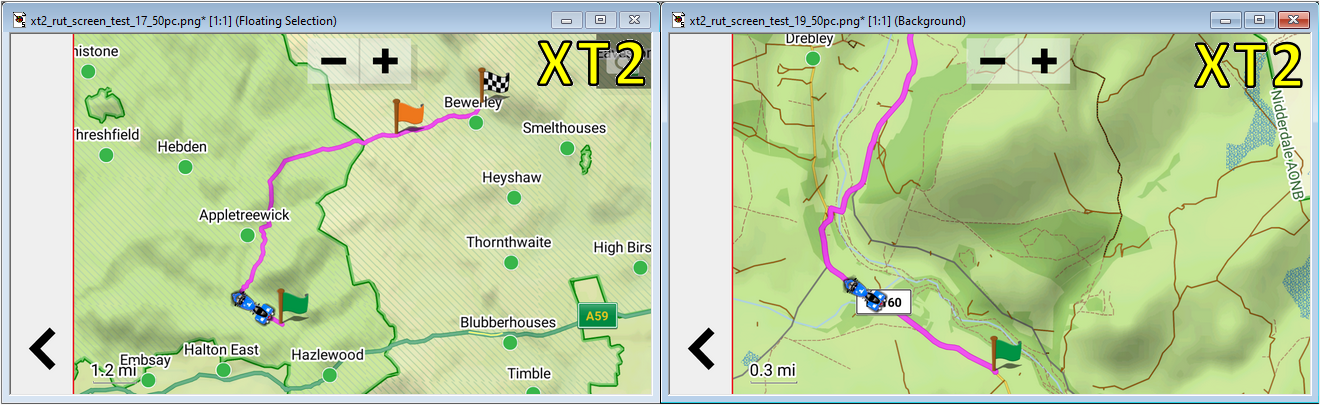

Image 3. 9:49am. Approaching A59 Roundabout
This is about 3 miles later, approaching the A59 roundabout. Curious that with identical routes and identical maps, on sat nav thinks that the next Via Point is 2 miles further away than the other. Both had recalculated the route after I had pressed Skip. Perhaps one has calculated a slightly different route from the other. If so, I didn't see it - but that remains a question mark - I will take a look at the distances on the simulator.
One of the screen shots is taken slightly later than the other - but that is of no consequence. The significance of the roundabout is that I am not going to follow the instructiosn. I am taking the 2nd exit - the yellow road heading towards Bolton Abbey.
XT2 vs XT Routing 03.png (515.97 KiB) Viewed 3721 times
Conclusion: There is a slight difference in time to be investigated, but I expect both Zumos to compain when I do not take the third exit.

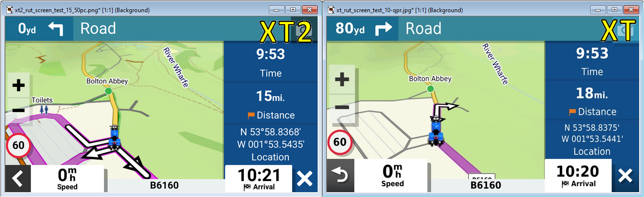

Image 4. 9:53am Turn Back Loops and U turns.
These are to be expected. The point where it is faster to continue ahead - identified by repeatedly moving the bike's current position and asking it to navigate to the end point - is a few miles further ahead. The XT2 seems to prefer turn-round loops initially, but it later demanded U turns.
The XT - well - - I messed up. I had reset the XT and forgot to check the U turn status - so that too found loop back routes or side roads. Later, I switched the XT to allow U turns. More later. Never mind - this is about the XT2, and what that does when it reaches the tipping point.
Note that the distances to the last Via point are both increasing - because the Zumos are expecting me to go back to the roundabout.
XT2 vs XT Routing 04.png (458.16 KiB) Viewed 3720 times
Conclusion - U turns / loop backs are expected behaviour on this section of the road. Both Zumos are beahving normally.

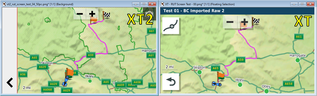

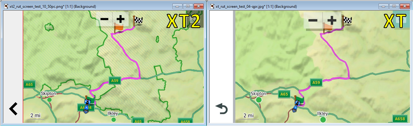

Image 5. Approaching the Tipping Point - 5 minutes later - where it is faster to go ahead, than it is to go back.
Half a mile before the junction, the XT2 has already identified that it can take the road I am traveling and get there faster than if it turns me back.
Look at the arrival times shown in the images for the last screens.
At the same point, the XT is still trying to turn me back by using the road on the left.
XT2 vs XT Routing 05.png (495.5 KiB) Viewed 3718 times

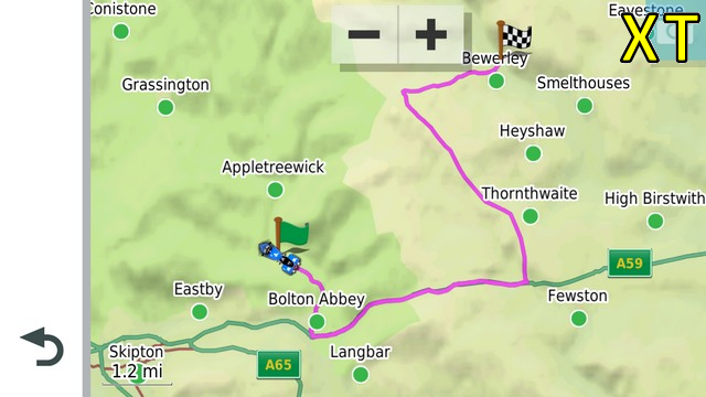

Image 6. The Remainder of the XT2 route on the preview map.
Both images are the same location. I zoomed in and took the right hand image because I noticed something different: The position of the green flag. ie the start of the current section of the route - after it had recalculated. Note also that the orange Via point and the end point are still in position. This is exactly what I believe should be happening - at each point, before deamnding a U turn to pick up its last calcaluated section of route to go back - it should calculate the distance or time to the next route point (via or shaping). If it is less than its previous calculation then yes - let's go this way please.
XT2 vs XT Routing 06.png (806.08 KiB) Viewed 3716 times
