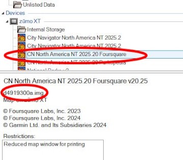

The map filenames do not match the map name. For instance, the 2025.20 Canada & Mexico City Navigator map is D9644080A.img. The filenames can be found in Basecamp:
- BC.jpg (28.08 KiB) Viewed 3701 times
The U.S. file is over twice the size of the Canada & Mexico file.
