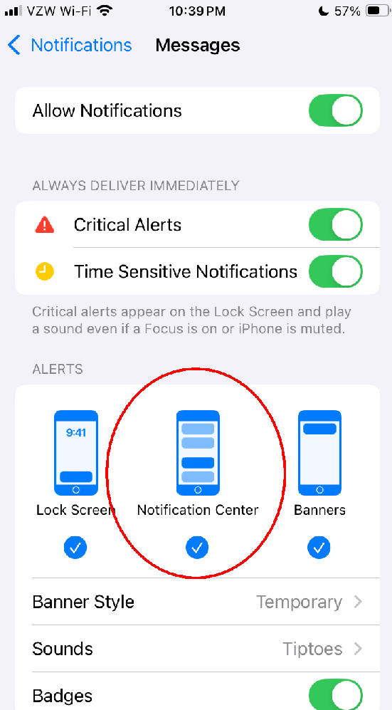

This is a quote of my solution to the same problem, which evolved from an inquiry I made a few weeks ago about pairing the XT to my Cardo as a phone or a GPS.
"On the iPhone, I went into Settings > Notifications > Messages. Two options in there were turned off. One was labeled "Time sensitive" under "Always Deliver Immediately" and the other was the radio button for "Notification Center" under "Alerts". I enabled both and a test text from my wife was displayed on the XT."
This is that discussion: https://www.zumouserforums.co.uk/viewtopic.php?t=3237

Thanks for the post Peabody. I've checked the first 'Timestamp' box you mentioned however there's no Notification Center/Radio Button within the Messages app. I'm on iOS 18.3.2

Ron from BC wrote: Sat Mar 29, 2025 12:23 am Thanks for the post Peabody. I've checked the first 'Timestamp' box you mentioned however there's no Notification Center/Radio Button within the Messages app. I'm on iOS 18.3.2

Nope....my settings mirror yours in that image and I re-paired the Cardo Edge as 2nd mobile to the XT. I have several items checked in Smart Notifications like Texts, Weather etc and I'm not getting anything. All I can get is phone calls in etc, it's as though the Smart Notifications are not set up however they are.
