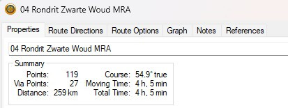

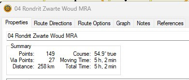

This tread is about the difference between MRA and Basecamp. But an other important factor is the MAP data. The same route in BC calculated with the CN 2026.20 and an OSM map shows only 1 km difference in distance, but 57 minutes difference in time. And yes they are visually the same.
CN:
OSM:
Every road is assigned a class in the map. BC, and the XT, use that road class to calculate the speed. Different road classes will give you different times.
Re: MRA trip time vs. BaseCamp/XT
Posted: Sat Jul 26, 2025 11:03 pm
by tombarrington
Seems like the application of road classifications would be fairly consistent. I don’t have the MRA Gold subscription but I would expect the MRA HERE map to give results close to CN given they’re the same or similar.
