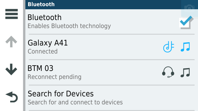

This one is before I have linked to the BT headset GLINBT18. In fact, Zumo doesn't know about it yet.
Note that my Galaxy A41 phone doesn't feature as a phone. Only Drive and music connections are established.
This is because all phone conversation - speaker and mic - have been linked to the XT and the XT is not connected to a device that has a mic and earphones.
If the phone rings in this state, I probably won't hear it.

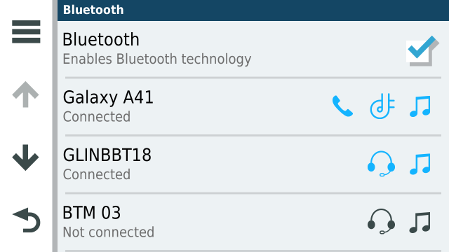

Here the cheap BT headset has been paired to the XT. It can handle headphone stuff (speakers and mic) and music.
But note that now, the phone has got the phone handset icon. It can now be used for phone calls.
When the XT is connected to the bike, and the BTM03 nodule is paired, the BTM03 icons are blue and the GLINBT18 icons are black. I normally tell it to forget the GLINBT18 device once I have finished testing.
