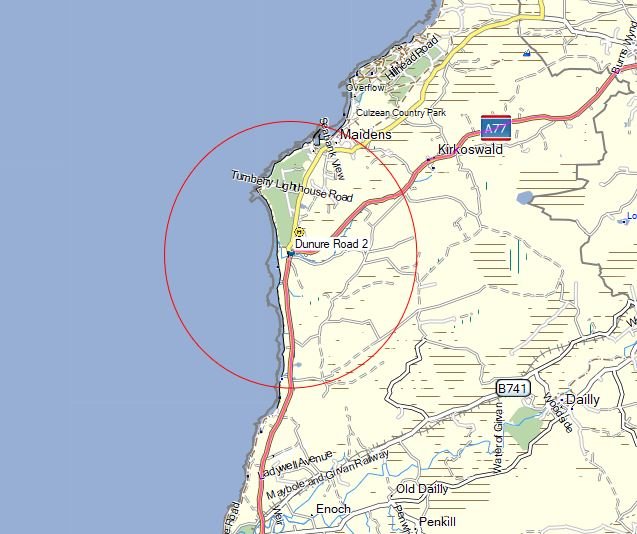

In Basecamp I can specify a "Proximity" value on a waypoint (Denoted by a red ring - see attached jpg) - I assume the theory is if, for instance, I set a value of 1mile diameter and I get within 0.5miles of the waypoint the Gps assumes I have passed through it and won't force me back to it. Has anyone ever got this to work? (I use an XT, but on any Gps?)

Proximity points alert on handheld devices but not automotive ones, where they have no effect other than to provide the circle marking.

Note that POIs are not the same as Waypoints or any other type of point in normal use on the Zumo.
POIs can be made to trigger the playing of an audio clip when you get within a specified distance.
That proximity circle may be used in later versions of the POI Loader.
More info: https://www8.garmin.com/support/downloa ... 7#Instruct
