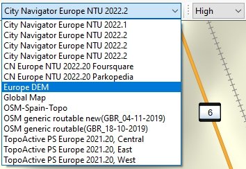

In Basecamp, when the Zumo is connected, the drop down list for the map selection will show the the maps that are on the computer together with the maps that are stored on the Zumo. You can select which maps you wish to use from the drop down list.
Maplist BC.jpg (32.56 KiB) Viewed 3561 times
Unhelpfully, there are three Europe NTU 2022.2 Maps listed - all with the same name. It is impossible to tell which one is which- but one of them will be the map that is on the computer. Two of them will be for the north and south maps for Europe on the Zumo. You have to guess.
If the Zumo isn't connected, I see a very much shorter list with only one Europe NTU 2022.2 map listed.

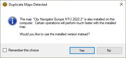

If you select one of maps that is not on the computer, you will get a warning indicating that you have selected the map on the Zumo, and that you already have the same map installed on the computer. In my case, the bottom one of the three with the same name is the one on the computer.
