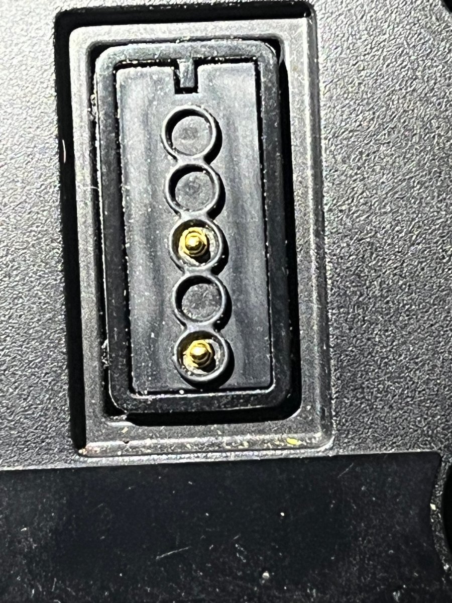

XT Mount.jpg (306.19 KiB) Viewed 2781 times
So am I right in assuming that I have the newer mount and the old cable?
Thrasherg
Posts: 46
Joined: Sat Sep 04, 2021 4:35 pm
Has liked: 10 times
Been liked: 7 times
Re: Zumo XT not recognizing it's on the cradle
Post by Thrasherg »
You are correct.. that is the old power lead and a new cradle..
