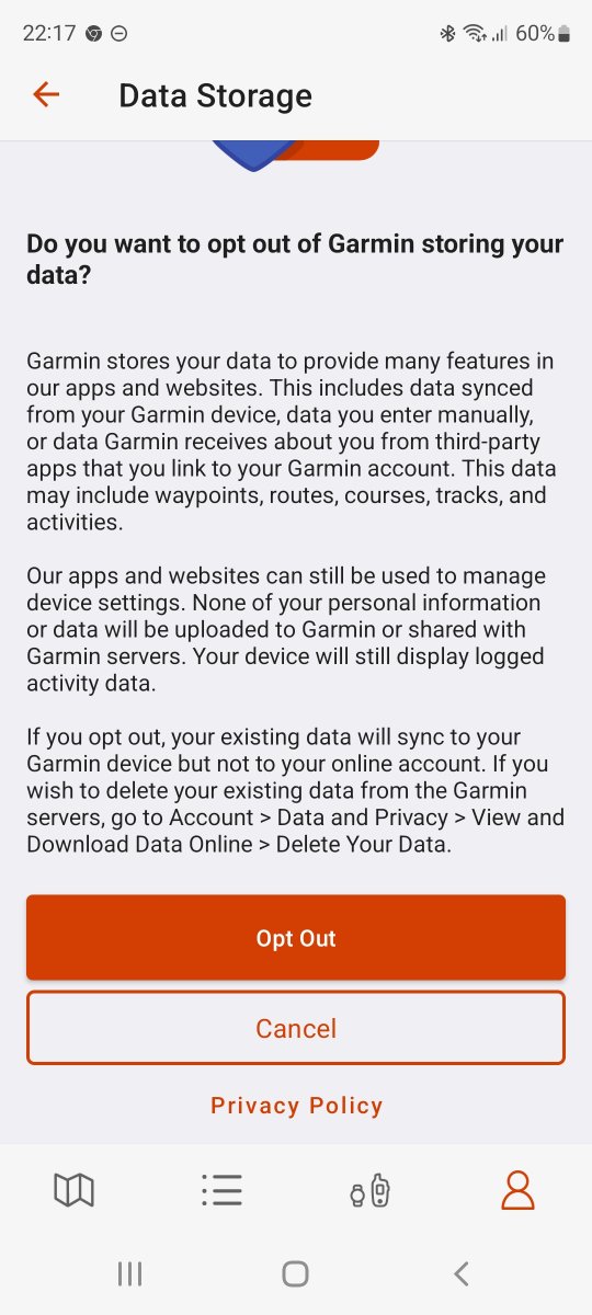

if you go to the app on your phone you can opt out of garmin storing your data I wonder if this will do what you are after?

Many thanks @Berin and @Stu
The section that @Stu mentioned prevents the data from going to and from the Explore account - which will do the trick.
Certainly making sure that the link to Explore is not longer present does the same thing.
Both should work - and at first test, like the things that I tried - they did.
