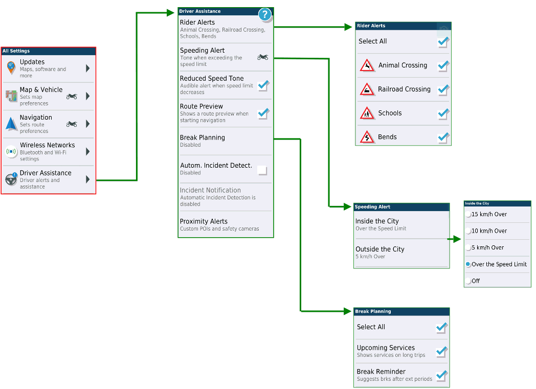

I reckon that it may be one of these. Note the various settings for both inside the city and outside - different amounts of lee-way.
The alternative is that it is relaying pings from your phone and has nothing to do with the XT at all.

I too, have been chasing this double tone alert...without success. JFHeath, my XT (USA model), does not have the secondary selections for Speeding Alert, i.e.,Inside city/Outside city and speed over. Maybe this is Europe only? The unit software is up to date.
Re: Has anyone determined what triggers the double-ding?
That's interesting, so I had a play around with some settings.
Those options disappear from my UK XT if I change the locale to USA. And instead, I get the crash helmet warning option !
Locale is in the hidden menu obtained by long pressing the circular speedo button. Available in Configurations and Settings.
But that is irrelevant to your ding ding problem. Try unpairing your phone to eliminate that as a possibility.
