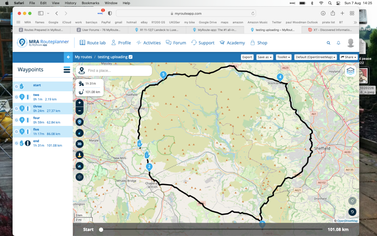

is this correct for sharing?? excuse my stupidity https://www.myrouteapp.com/route/open/6445845
Image this is the route I was playing with, the via/shaping are only named as such as I am practicing. As I wrote it has uploaded ok to the XT just no 2-5, it's got to be something I am doing.
One thought though - are you sure that you have used routing points on MRA correctly ?
Tear drop icon = Shaping Point
Hand icon = Via Point.
I did not realise this although I believe I have done by luck more than judgment.
I will rename the route and go through the process again to see if I get same result,

@jfheath thanks for your assistance here, I am getting to understand this machine a lot more now.
this is the route I was playing with, the via/shaping are only named as such as I am practicing. this was supposed to be in the above post, but messed it up DOH
Screenshot 2022-08-07 at 14.25.37.png (1.02 MiB) Viewed 2591 times

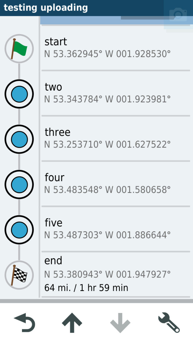

Both produced the same results in the XT. The route came through correctly as the original with the start and end and five shaping points.
Here is the route list in the XT: Note - all the following images are in their original resolution. Click the image to see a better quality.
Paul 3.png (198.48 KiB) Viewed 2579 times

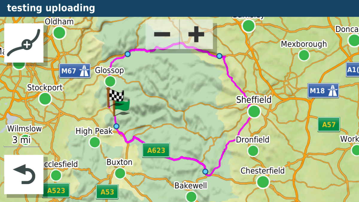

Here is the same route - as you sent on MRA shown on the XT preview map
Paul 4.png (1.02 MiB) Viewed 2579 times
All route points accounted for - note the shaping points have smaller blue discs.

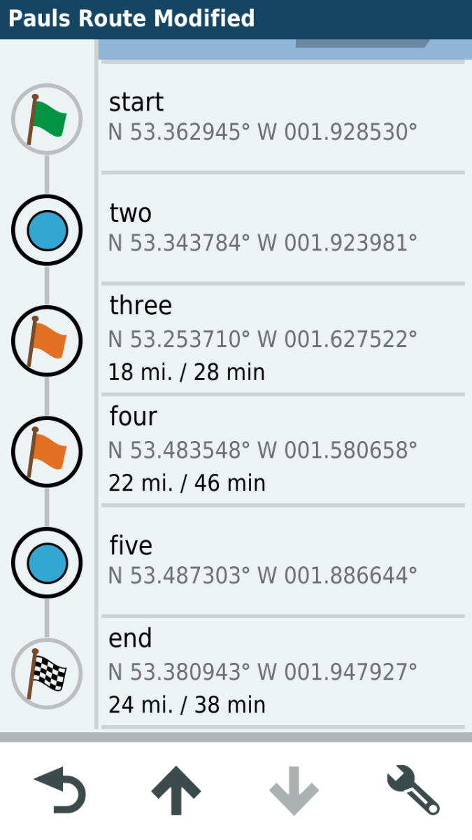

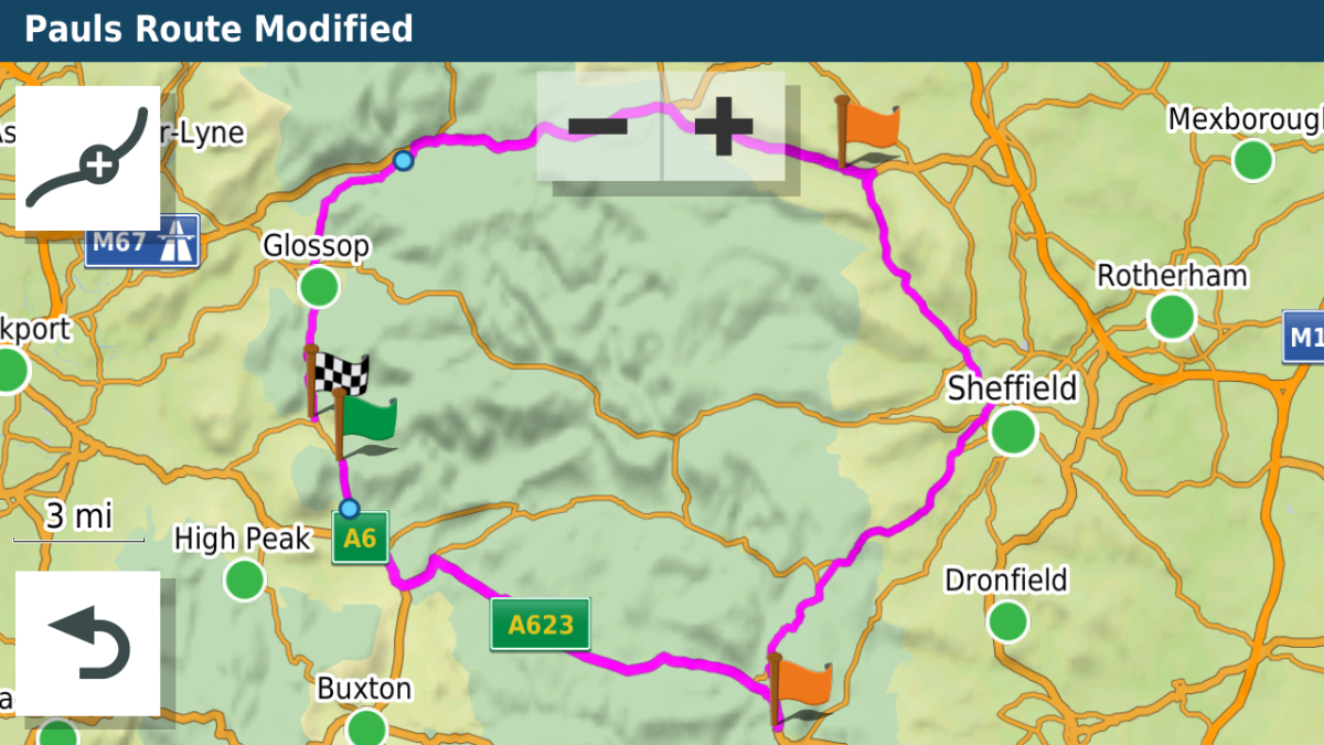

I changed points three and four to Via Points. Here are the results in the XT
Paul 5.png (206.08 KiB) Viewed 2579 times
Paul 7.png (1 MiB) Viewed 2579 times

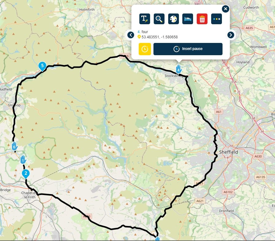

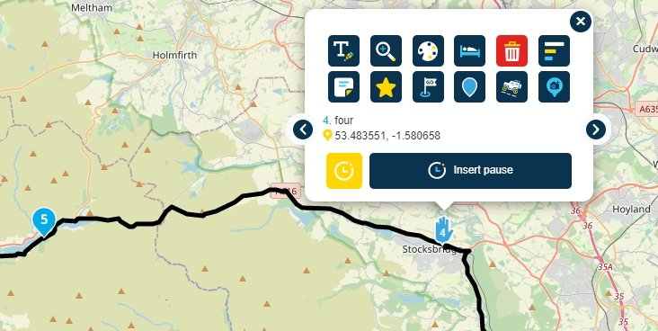

The facility to change the route points (MRA confusingly call them 'Waypoints' - which mean something completely different to Garmin ) was added relatively recently. I didn't touch MRA (or Tyre) for a long time, simply because it didn't make the distinction between Via and Shaping points. When they did introduce it, I bought a life membership.
The facility isn't obvious. Here is you route just after I changed points three and four to be Via Points.
Note that three and four are now represented by a hand, and not a tear-drop.
In order to change them you click on the tear drop, and a pop-up menu appears. Like the one above. Here I was about to change the hand back to a tear drop. There is no option ont he po-up menu, so you have to press the button with three dots - which displays a more detailed menu as shown below.
And now another exapnded menu appears. If the point you clicked was a hand, then you get a tear drop button - as in this example. If it was a tear drop, you get a hand.
So for the XT hand means a stopping place - a Via Point.
Tear drop means - well, a marker to force the orute to through this point - just a shaping point.
