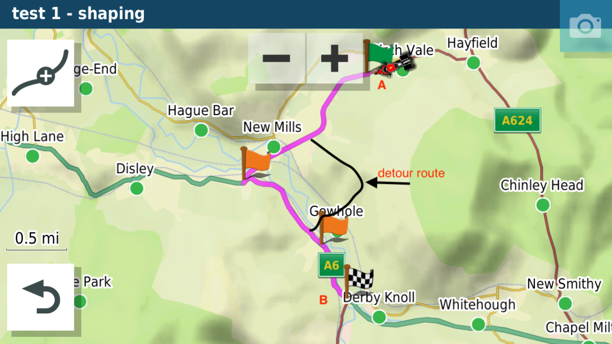

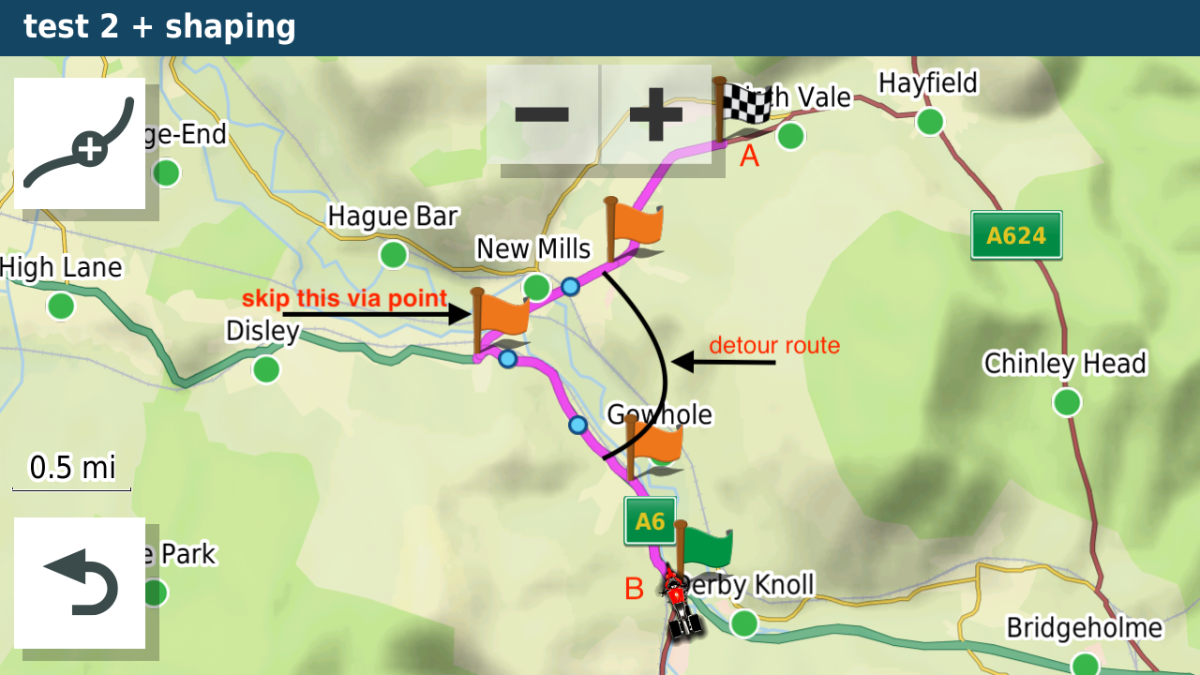

I went out today and tried to emulate this occurrence, here are my findings.
I planned two short routes only about 5 miles using MRA, one route had via points (hand) only and one also having shaping points (teardrop), although I used the same via points, (reversed route)
The route A to B had via points only , the route B to A had shaping and via points, I carried out a number of trips using various settings on the XT. the black line drawn on the screen shot is the detour route I took each time. the via point on the screen shot is marked to show which one I skipped.
full route shaping.png (781.25 KiB) Viewed 1516 times
full route no shaping.png (801.59 KiB) Viewed 1516 times
test 1 A to B
recalculation off, did not use skip.
all started well, I deliberately turned left onto my detour route, the XT went quiet, I did not hear any spoken instructions again for this route. even when I rejoined the magenta line on the A6, the XT did not restart the spoken instruction.
test 2 B to A,
recalculate off did not skip, this time the route had shaping points.
started good, I turned right off the A6 on to the detour route, again the spoken instruction stopped, when I rejoined the magenta line on the A6015, the spoken direction did not return.
test 3 A to B
recalculation on, did not press skip.
after departing A, I then turned onto my detour route and whithin 2-3 hundred metres the XT wanted me to u-turn and it kept doing this even when I turned left onto the A6, which was actually back on the magenta line, even when I passed over another via on that route, XT did not stop asking me to u-turn, I presume it wanted me to go back to the initial via point I missed.
test 4 B to A
recalculation on, this time pressed skip to avoid via point(marked on screen shot)
after I departed and turned off the A6 on to my detour route, the XT recalculated, initially wanting me to u-turn, I pressed skip next via point, and it calculated a new route along my detour route. all was well until I reached the junction where I should turn right to rejoin route. the XT wants me to turn left. the reason for this, is, that there is a shaping point about 400 metres down this road. I ignored the instructions to turn left. and turned right the XT knew I was back on the route and then forgot about the shaping point behind me, and continued instructions to end of route.
this is fine, as I knew where I was, however, if we are on a diversion route and do not know where we are in relation to the route, we would potentially follow the instructions only to have to turn back again.
if you look carefully at the screen shot, you will see a via point on the right, which is the correct route, XT wants me to visit shaping point left. this is on the original route and a few hundred metres after the skipped via point. if I had followed the original route I would have came from the left.
