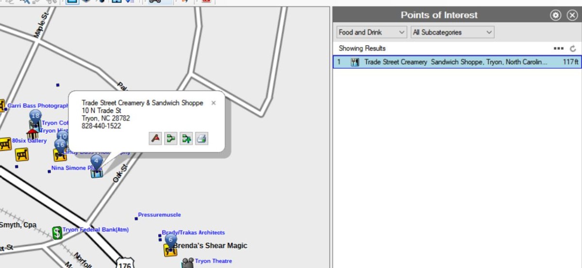

Duplicate listings of POI's is common but while trying to figure out my list display problem I noticed that the POI's listed stop at the first one that has 4 listings. I say for because the number in the map balloon is always 3 higher than the number in the list. Below is a screenshot. Cause? Solution?
Basecamp POI oddity.JPG (78.39 KiB) Viewed 5171 times

Peobody wrote: Tue Oct 11, 2022 9:50 pm Duplicate listings of POI's is common but while trying to figure out my list display problem I noticed that the POI's listed stop at the first one that has 4 listings. I say for because the number in the map balloon is always 3 higher than the number in the list. Below is a screenshot. Cause? Solution?
Tap the 3 dots. That will expand the list.

sussamb wrote: Wed Oct 12, 2022 8:27 am Tap the 3 dots. That will expand the list.
It doesn't. The list stops at whatever POI appears to have four entries. Sometimes it is the first entry like in my example, sometimes it is a POI that is further down the list. The crux of the problem is the four entries. Any thoughts about the cause of that?
FWIW, POI's with two entries are common and not a problem. I haven't seen a three yet so don't know if the listing problem is triggered at three or four.

Peobody wrote: Wed Oct 12, 2022 2:12 pm

I made some progress although I don't know which of the following made the POI list behave more like what I was used to.
1. I rebuilt the ProduceDataCache by renaming it. This made an obvious change whereby the POI restaurant that I showed in my screen snip as being listed four times was now only listed twice.
2. I then discovered that the tighter the zoom the better the POI list behaved. The zoom adjustment was done using Ctrl+mouse wheel.
I am feeling a little better now.
