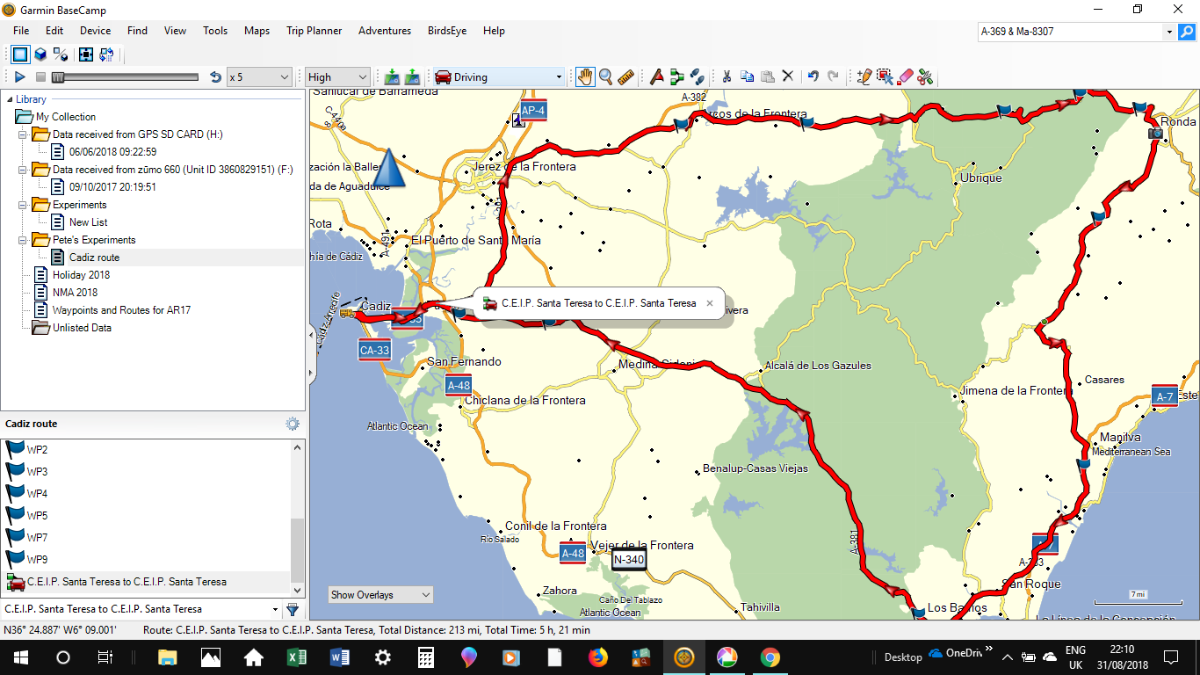

Pete, I stuck a few more shaping/waypoints on your route and came up with this:-
For simplicity, I just numbered the shaping points (mostly)

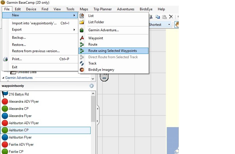

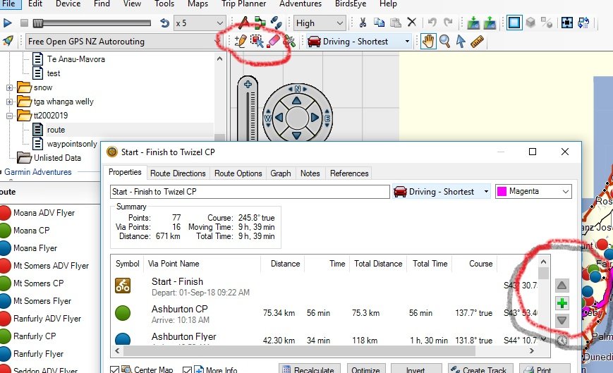

are you building a route with waypoints?I have done this recently.So you have LIST with your waypoints shown?
start drawing your route with the file/new routes with waypoints(have a waypoint selected)
when you have your route line showing or completed when you double click on it you get a dialog box where you can add waypoints and change the order of the way points to your own logic,not the machines logic..You can add and move shaping points using the tools at the top

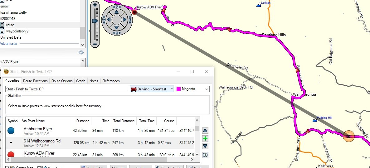

You can see the sequencing here.I have clicked the add a point button and when you have the route open you can see the "logic" as you move your mouse close to the route.That black line appears between a shaping poin(614 Waihaorunga Rd and the next way point (Kurow adv flyer).You can select the sequence of events not basecamp.I am not sure of the zumos "modes" but if possible you need to be in the same mode in basecamp and the zumo.Once you have sent your route to the zumo the fun begin again as the zumo may recalculate it.I had the most success using"cross country" in basecamp.The other thing is to make sure your avoidances set in basecamp.If you want a route with gravel roads then make sure basecamp is not avoiding gravel roads.Enough shaping points will work too but i am not sure if the zumo has restrictions on the number of points.I would make a seperate route for every day.Send the waypoints to the zumo too then if all else fails you can navigate from where you are to the next waypoint straight on the zumo

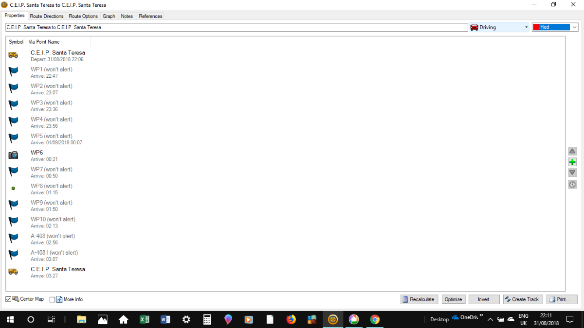

Re: First question
Looking at the BaseCamp screenshot try changing the profile from Motorcycle to Car. The Motorcycle default avoidances are many compared to Car and can produce quite strange routes, or edit the default settings in the Motorcycle profile.
Then use the 'rubber band' technique to insert sufficient viapoints so the route goes the way you want.
