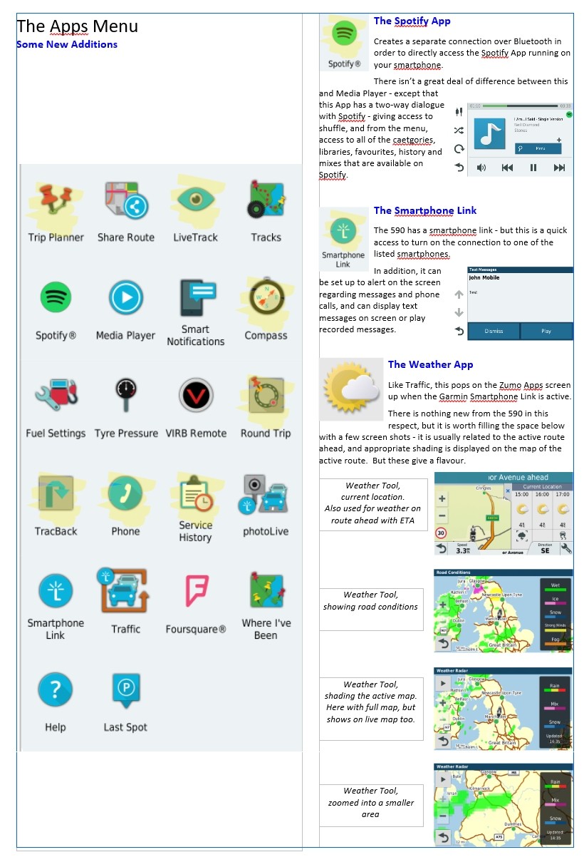

I have a 590 which is currently running the 595 software.
I like the additional features on the 595.
Years back, when I first switched my 590 to use 595 software, I started writing up the differences between them, but I never finished it. But what I have written picks out most of the nice features.
I can't include a copy of the pdf file on this site, but I might be able to add screenshots..... Yes I can.
Its not written as a comparison - it is written looking at the features of the 595 and commenting. In many cases the 590 had a similar feature. The 595 improved on these.

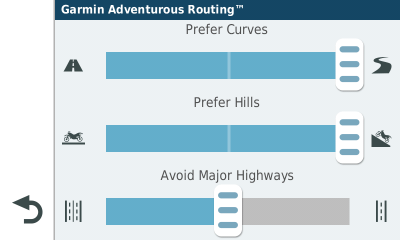

One other addition that springs to mind is Garmin Adventurous routing - which is an improvement over the Curvy Roads that I think the 590 had. With adventurous routing you could set each of three criteria to one of three settings.

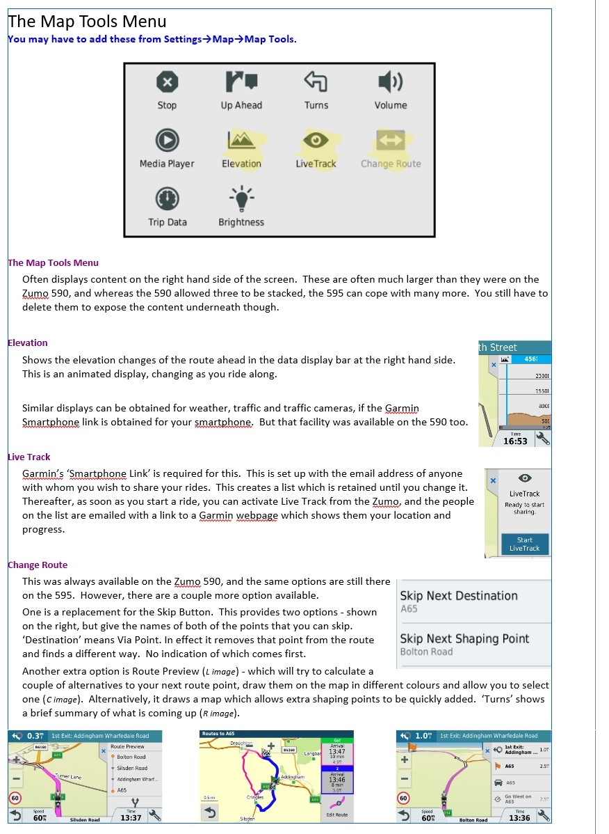

Edit route instead of Skip route point. Allows you to select from the next Via Point and names it or the next shaping point and names that.
Adventurous routing
Spotify control via Smartphone - although I understand that this no longer functions as a result of changes at Spotify's end.

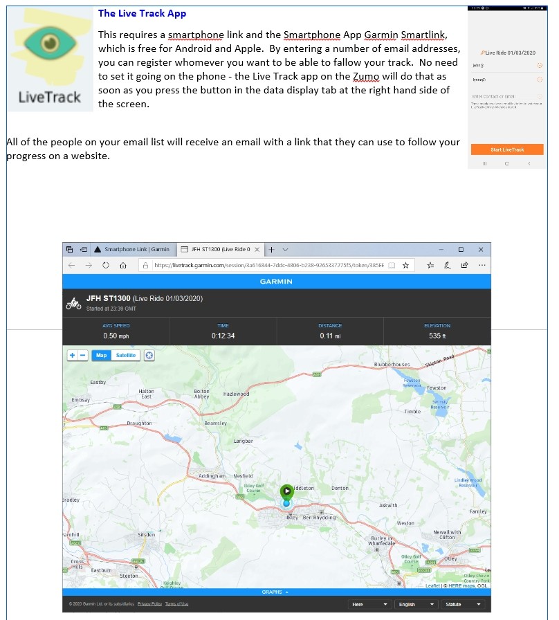

Live Track - set it up, and when you start a route it will inform nominated people where your track log can be viewed in psuedo real time.
Photo Live shows live image captures of major road junctions.
Screen shots below are all from the 595.
Adventurous routing

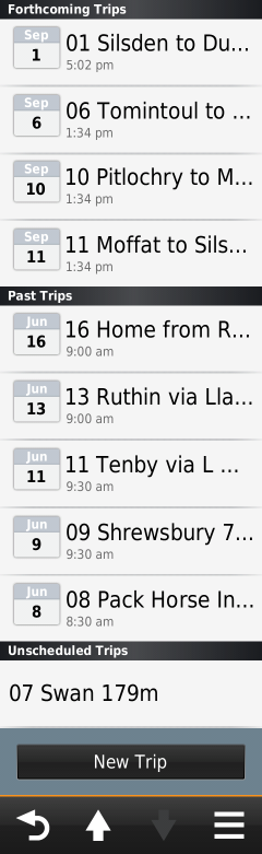

Another comment regarding the Zumo 590 and Zumo 595.
A Feature that the 590 has that I have not seen on any other Zumo.
The ability to organise the trips into date order. Not just sort - but organise them.
Here's an example. Click the link to see the full size image. Clearly I have combined a number of screen shots in portrait view to obtain this list.
Today is November the 30th. The trips in the trip list are all set with the date of departure set for the Via Point at the start of the route.
The list shows all of the trips which are planned with a start date in the future - the soonest one first. (So 1 Sep to 11 Sep 2023).
The Past trips are sensibly shown in reverse date order, so the most recent route is shown at the top.
Below that are the routes for which I have not set a date.
This list is dynamic. If today was the 1st Septmeber 2023, then I would be riding the route at the top of the list. Silsden to Dumfries.
Tomorrow, that would be at the top of the PAst Trips list, and 06 Tomintoul would be at the top of the Forthcoming Trips.
Now why didn't they keep this for the 595 or the XT ???
(Although the list will still sort into date order if you set the date of departure for the start point. Annoyingly, you cannot do this on the XT. You have to do it in Basecamp.)
