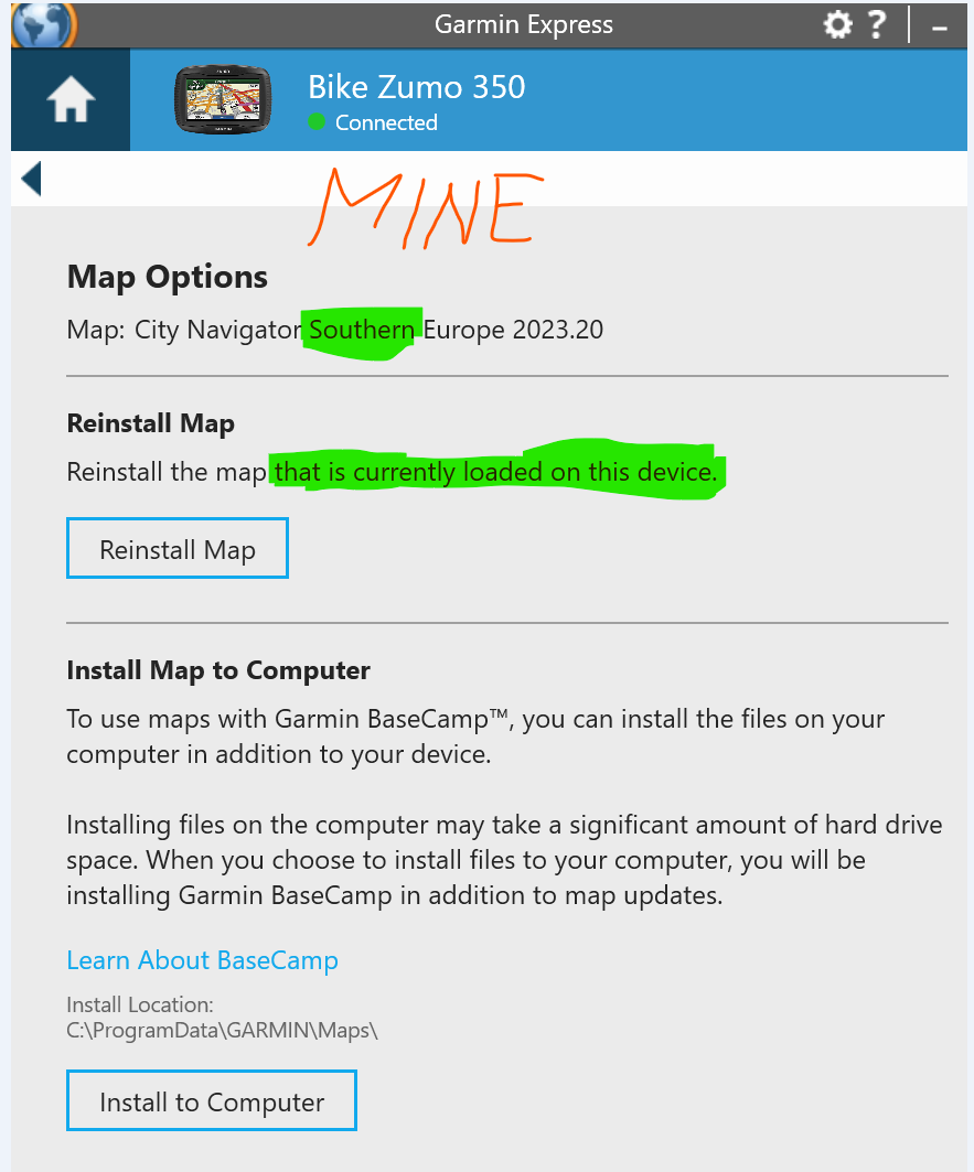

Yes, I have the same issue with my Zumo 350LM.
Just the UK that is base map only.
So I tried a new sd card (so effectively deleting the map) and it downloads CN Southern Europe 2023.20 (should be Full Europe). I think it may have installed to the internal storage (not the SD card) and downgraded Europe to Southern Europe due to space, but not certain at this stage.

Exactly the same for me except I have a Zumo 350LM.
My first problem was the Zumo telling me it could not "unlock the map" but after some ill advised botched attempts to fix it I now find it is (re)installing "CN Southern Europe 2023.20" and to Internal Storage (8GB) (full Europe has to use the 16GB SD).
There is no "Manage Maps" button, only a "Reinstall Map"
I'm looking for a way to go back to "CN Europe" and make it use the SD card.

CN Europe NTU
2023.20 Southern Europe
If your refering to the Purchased tab in Tools & Content. That just says "There is no content for this device". There is also a message "We're having trouble retrieving all your purchased content."

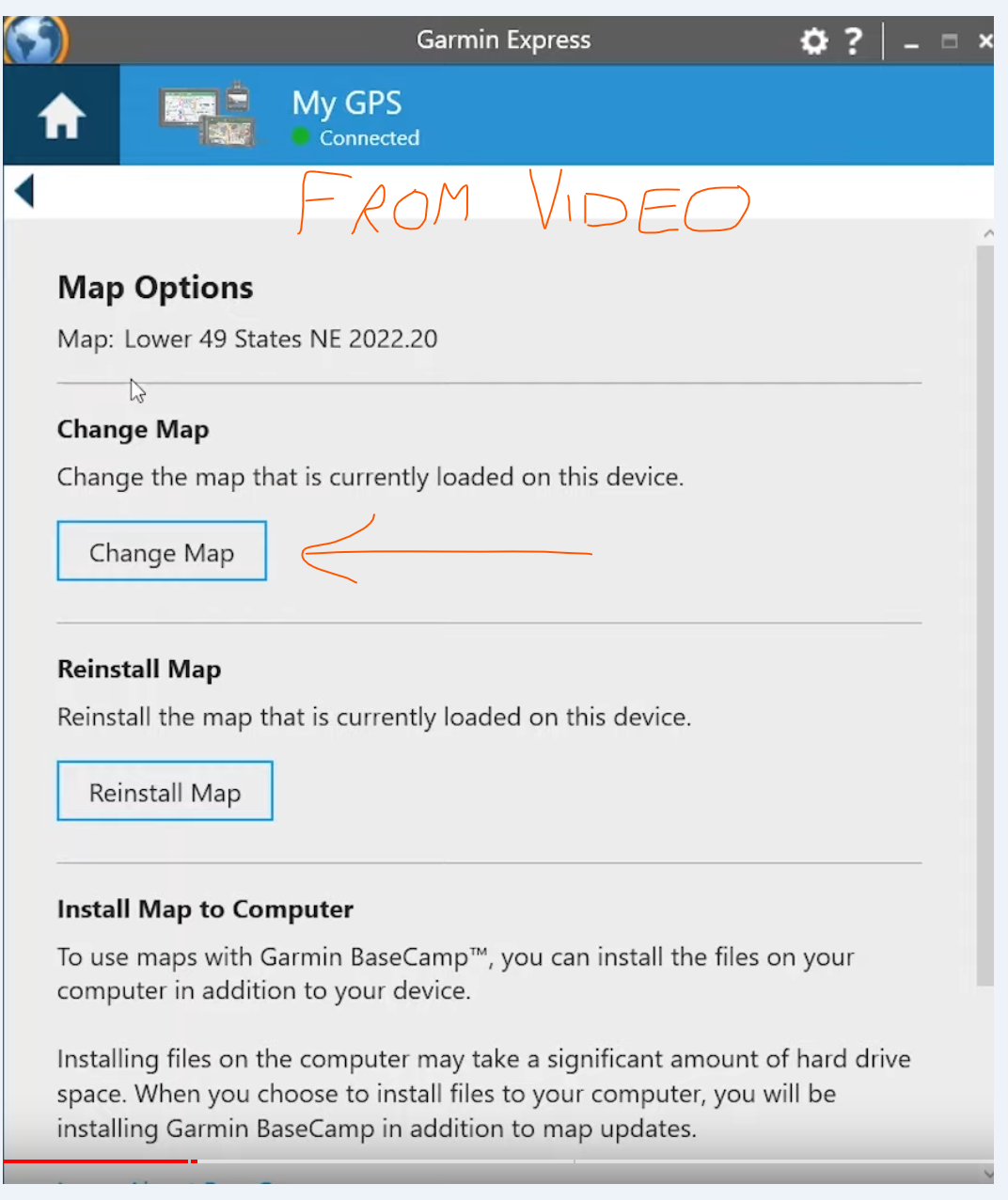

Yes clearly and if I had a change map button I would try it.
The video has a "Change Map" button but my Zumo does not. After a "Reinstall Map" I still have just Southern Europe.
Latest garmin Express 7.15.2.0, tried both Windows 10 and also MacOS 13.1
