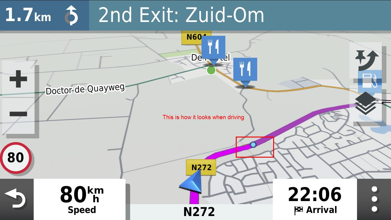

I cant remember having to setup anything. Maybe you find something here: app.php/ZXT-P87
This is how they look on my XT

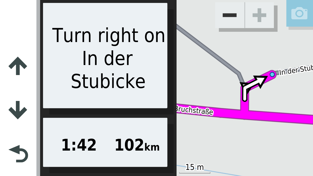

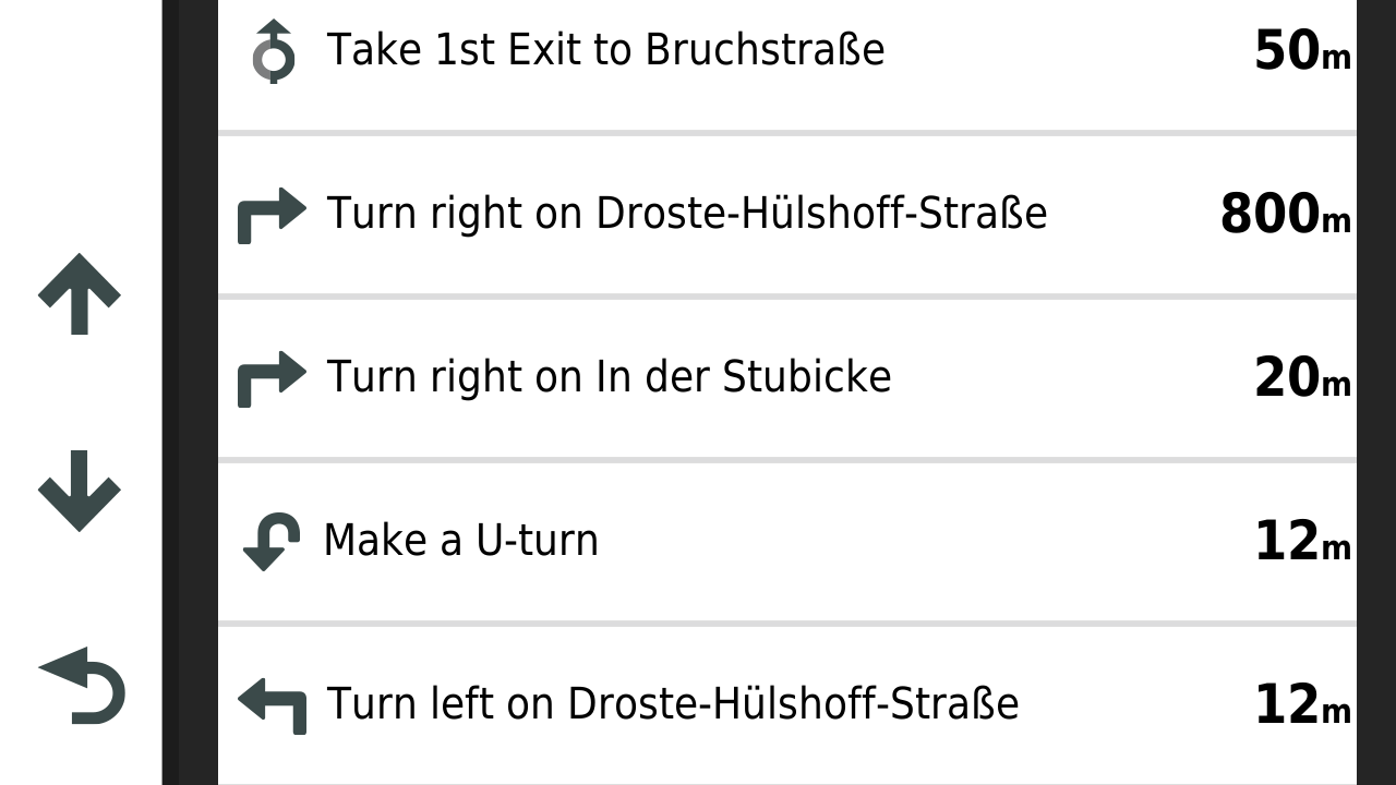

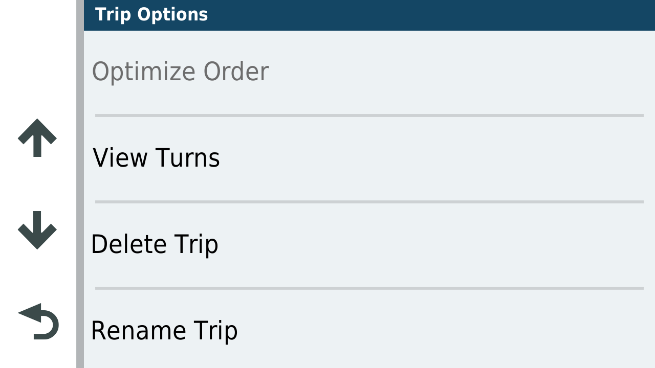

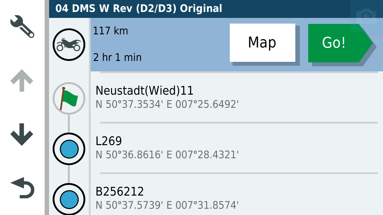

. Once the route/trip is loaded on the XT. (Maybe the evening before you actually drive it)
. Open the trip in the trip planner
. Hit the spanner. (wrench)
. Click on 'View turns'
. Look for 'Make a U Turn'. (This is always questionable)
. Click on it to make the map on the right visible.
. And there you see the offending shaping point.
This is something that actually happened to me. I'm sure you will not find all points in error, but it can be worth the trouble checking it before hand.
