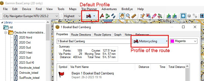

@chris7444
Just reading this post. If you set the routing profile in Basecamp be sure to set the Profile of the route. That is what is sent to the XT, not the Default.
Happened to me on a few occasions.
Route Profile.jpg (102.42 KiB) Viewed 3225 times

FrankB wrote: Sun Feb 26, 2023 6:27 pm @chris7444
Off-topic: In the past I have always made sure that no recalculation is done on the XT. But lately I send a track from the route to the XT, and make sure that the route does get recalculated. When all is done I verify that the track and trip on the XT are the same.
Why do I do this? When you deviate from the route while driving, the route gets recalculated anyway. Possibly a route that I do not expect.
Yes I did that.
