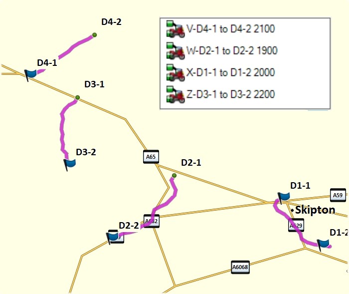

Ok - I've been experimenting sending the routes to SD card.
The filenames are indeed called Route.gpx, Route1.gpx, Route2.gpx, .... etc if you use Basecamp to transfer them. Regardless of the contents of the file, the transfer picks out each individual route and saves it in its own Routenn.gpx file.
The same is true of any tracks that were sent in the same transfer process - except of course the filenames are Track.gpx, Track1.gpx, Track2,gpx,.....etc
So here was an experiment. Four routes, each carefully named - summarised in the following map from Basecamp - click it to see a slightly larger version.
I plotted 4 Waypoints - D1-1, D2-1, D3-1, D4-1. Each point moving further away along a SE-NW line from my present position. D1-1 is the closes to me - I'm just off the righ hand edge of the screen.
I then plotted 4 more waypoints D1-2, D2-2, D3-2, D4-2 - each point placed roughly SW or NE of its respective partner.
And then I created a route between each pair of points.
Then I named the routes as shown on the map.
Each route started with a letter - V-W-X-Z alloctaed to try to determine whether the routes were sorted into alphabetical order.
D1, D2, D3, D4 were gettin successively further away from my presnt position.
The I allocated a departure time and date for the first point of the route.
I used 1900 on the 19th Feb, 2000 on the 20th Feb, 2100 on the 21st Feb, 2200 on the 22nd Feb
You can see from the table of route names that you can tell how they are being sorted.
Using Import displays the routes in this order.
V-D4-1 to D4-2 2100
W-D2-1 to D2-2 1900
X-D1-1 to D1-2 2000
Z-D3-1 to D3-2 2200
This is alphabetice order - VWXZ - It isn't in Distance order 4213, or in time/date order 21,19,20,22
Once imported, when selecting a route ifrom trip planner they are shown in this order:
W-D2-1 to D2-2 1900
X-D1-1 to D1-2 2000
V-D4-1 to D4-2 2100
Z-D3-1 to D3-2 2200
This is in date / time order. The test doesn't distinguish time or date. Experience leads me to believe that they are shown date order first and then time order if two routes are listed for the same date.
The Route points were created as Waypoints - so they were all transferred to FAvourites / saved.
These were shown in Distance order from my current position :
D1-2 1.5m
D1-1 5.2m
D2-1 13m
D2-2 16m
D3-2 21m
D3-1 23m
D4-2 27m
D4-1 27m
Finally, you dont have to use the names given buy the XT. Any named gpx file will be recognised by the XT - and if you create the gpx file and then drag and drop it into the Garmin/Gpx folder, you get the name that you want.
The above may help your naming convention so that you can predict the order in which the names will appear.
